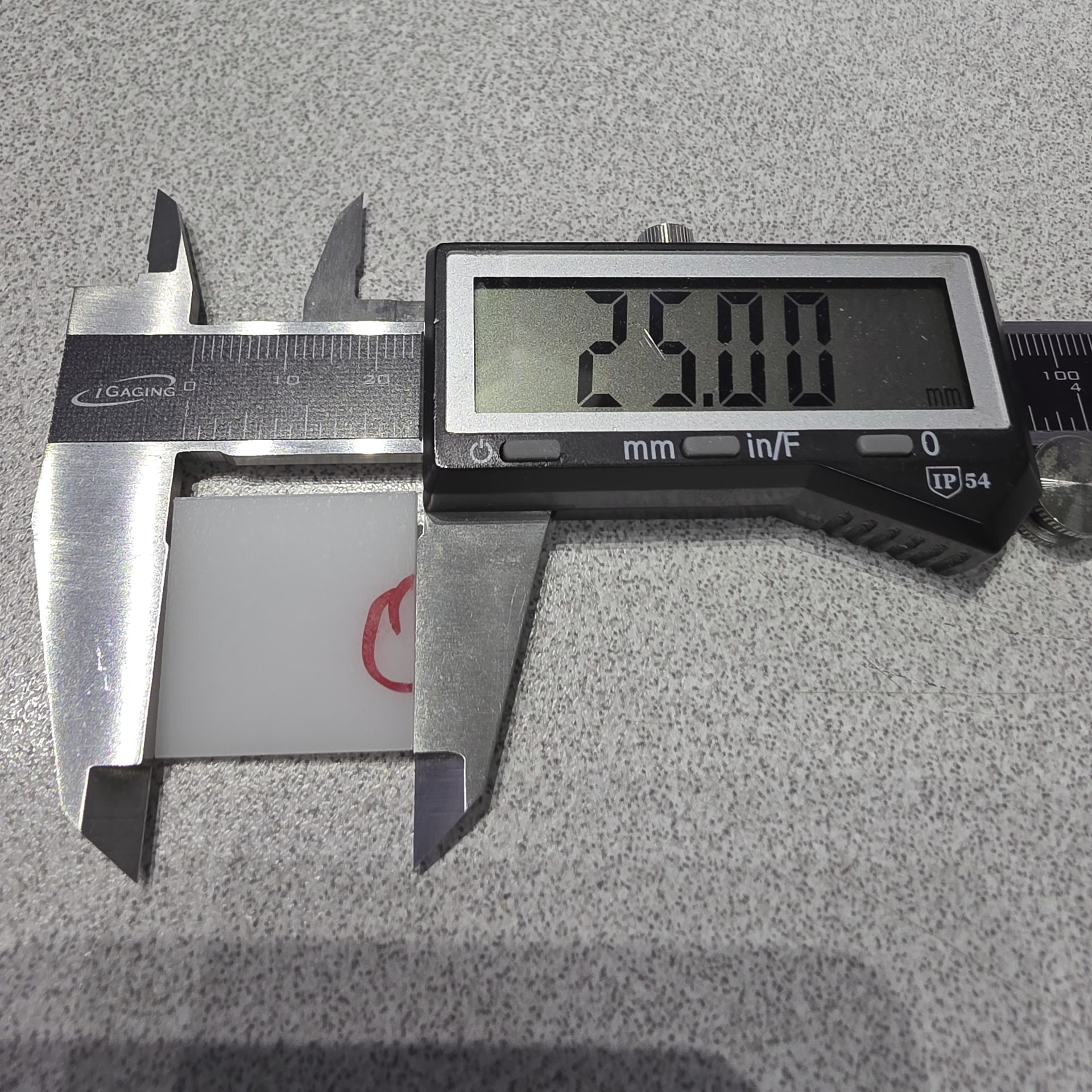

so after 1 year of cutting I decided to take a look at a ‘square 25mm x 25mm ‘ !
as expected it was not really square (see pics)
Now I realize this is pretty dang good, but the engineer in me, is bugging me to ask the obvious question !
“How do I get it perfect ! “

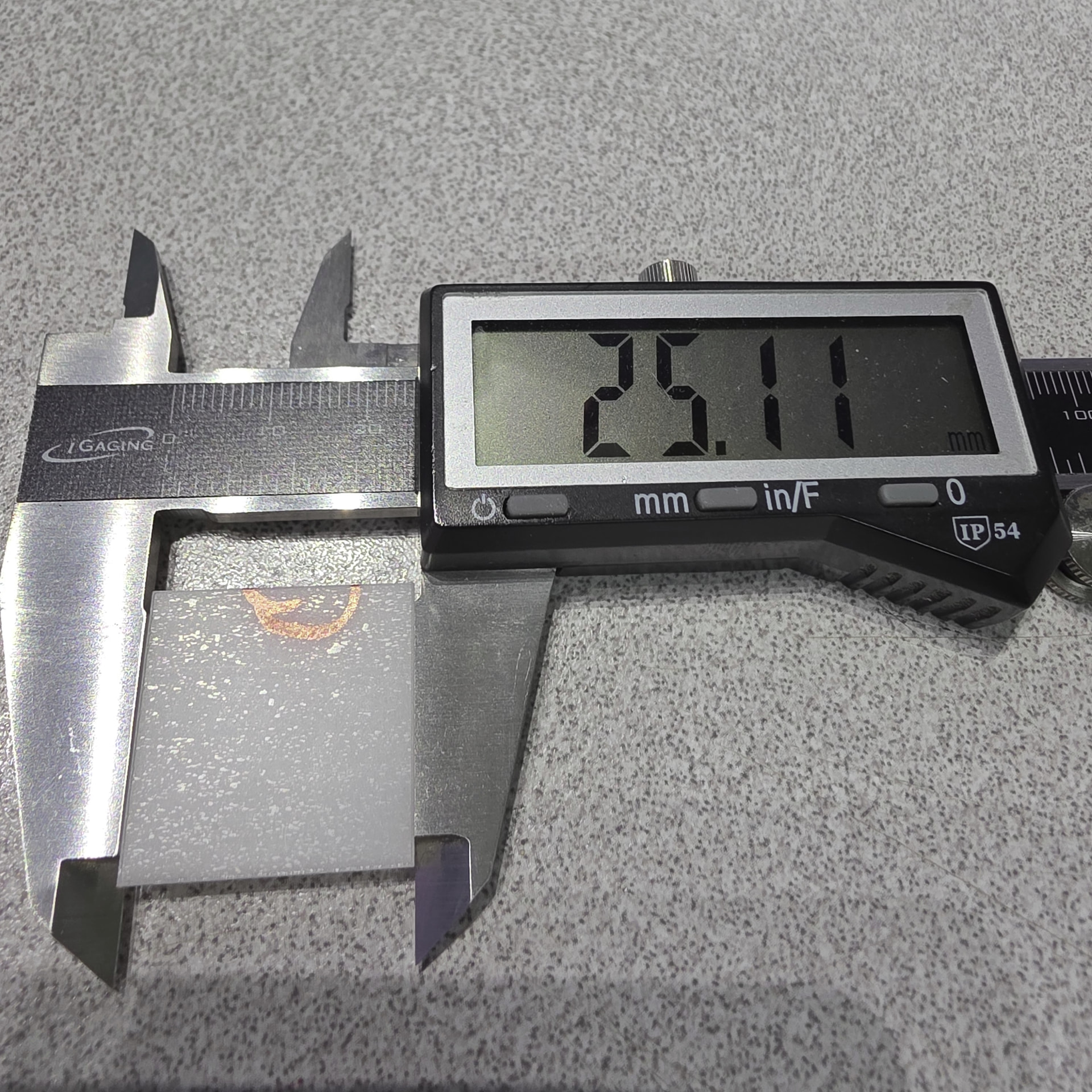

I’ve adjusted the cut kerf to get one side to 25.00 as you can see, this was the x axis, so the y axis
seems to be off a bit 0.11, and could be adjusted.
FYI ( I have cut 5 squares to ck for repeatability and yes it is repeatable ) same delta..
I would concede that I am ‘really’ being picky and and should just move on with a big smile…. BUT !
I would like to know, from all the experienced folks here, if there is a preferred method to adjust the 0.11 out of the cut on the y-axis. ( as kerf is for all cuts, as in LB I could not find an X kerf / Y kerf setting….
Also: I checked to see if the 0.11 was additive over size, so I cut a 100mm x 100mm square.
the x-axis was still good , but the y-axis ‘was’ additive it showed 0.33 which would be correct for 4 squares next to each other… so Over length we have a build up that looks like it should be a candidate to ‘adjust out’ this error.

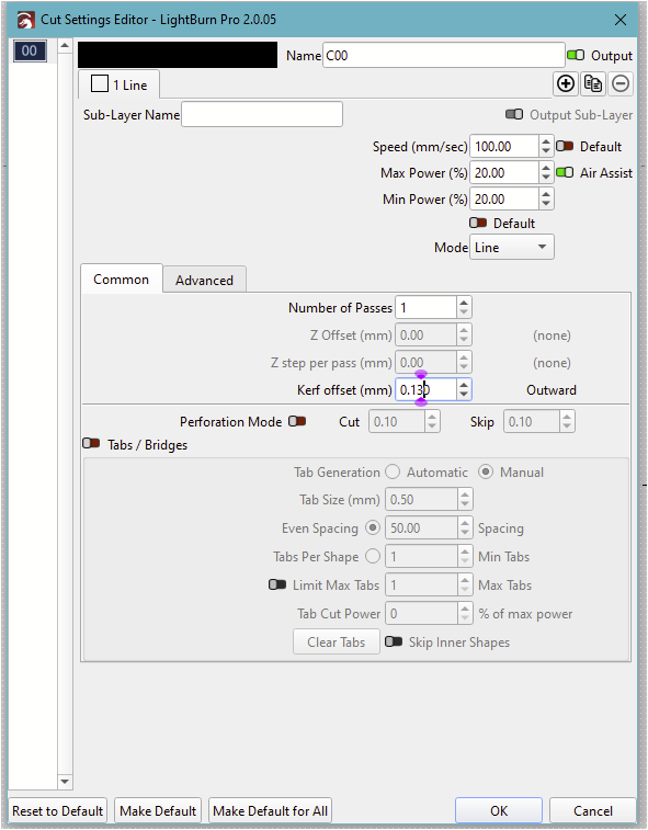

If it is not a mechanical or optical problem I will change the settings for steps on the relevant axis, it is (on Ruida machines) relatively easy and quick to fix.
And of course it has to be perfect! :wink::+1:
:slight_smile: was looking at the Y step, but wanted to drop in here first….
This is the way. Just be sure that you measure to the center line of an engraved line rather than a cutout piece. The kerf has width and you must measure to the center. If you measure to the edge, the calibration will only be perfect at that dimension.
Yea I did the center line and got the kerf out of the equation for these cuts…
now it is just the sizing, I believe
EDIT:
Yup…. did not earlier see the calibrate axis, was very handy…..did the Y change in steps
cut / measure .. Perfect….
but that was with the Kerf offset made
so I’m thinking I should set this back to 0 and do the calibate for both X and Y axis again
to tweek it in for the kerf ??
EDIT 2:
ok set Kerf to 0 recalibrated thed X and Y steps… remeasured 100 x 100mm square 99.996 x 99.998
so I guess I can live with this ! :slight_smile:
again thanks to all (TIM) as usual the folks here come up with all the right answers…
Chuck
As @thelmuth points out, measure lines marked on the surface, not cuts. Adjusting the kerf without accurate step sizes for both axes will only confuse the issue.
Measuring a cut square as you show also has issues. If the cut is not a clean perpendicular edge, you’re also measuring:
  • Cut angle w.r.t. the top / bottom surfaces
  • Edge irregularities
  • Beam irregularities
  • Axis angular misalignment
  • Crud melted off the mask film
Don’t adjust the kerf to make the answer come out right. You must measure the kerf in that material, then set the offset accordingly:
Also, verify the head’s angular alignment to ensure it’s not cutting a diagonal on the Y-axis faces.

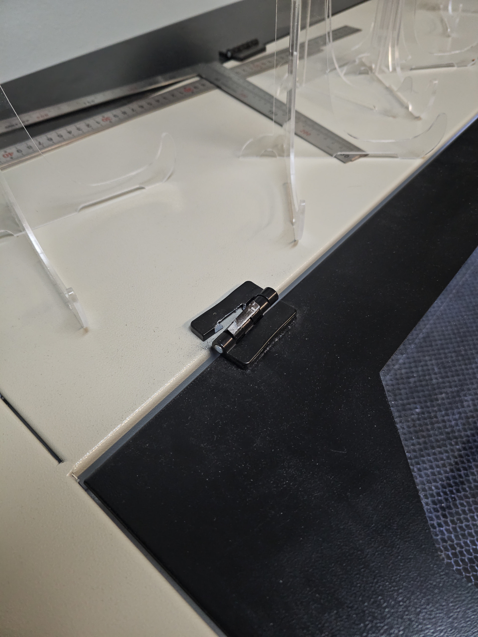

also had to replace a Lid hinge…..wow My son was using the laser, opened it and closed it….SNAP…
but the lid on this unit is big so…. just surprized, luckily on Aliexpress, ‘everyone’ sells these hinges….
Surely made from the second-finest pot metal ever poured from a crucible of mixed scrap!
My 700×500 lathe has three lid hinges, each sporting two-in-three fingers: the premium version with Number One fine pot metal. :grin:
You’re running that machine hard; keep up the good work!
yea my bed is 1320 x 900 so 3 small 50mm hinges,…. well nope…..
need a nice BOAT Piano Hinge…..in case I want to take it to the beach… :slight_smile:
