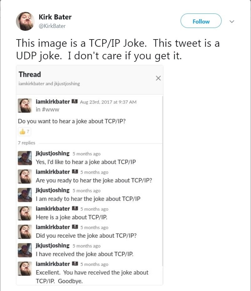

UDP doesn’t have any sort of handshaking or acknowledgement that packets were sent or received. It just spits the info out, and hopefully it gets where it needs to get. There’s a higher chance you’ll lose packets or ‘not get’ them.
Haha, probably would have needed a wink to get it…
I wrote that at something like 1:30 am just as I was about to pass out. The wink was an afterthought.
I’m glad you got it… maybe?
UDP packet bar walks a into.
There are a lot of these. (UDP packets are not guaranteed to arrive in order, or even arrive at all)
Google UDP joke or TCP joke and you’ll find lots. Some of them are even funny.
