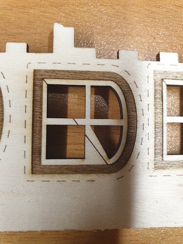

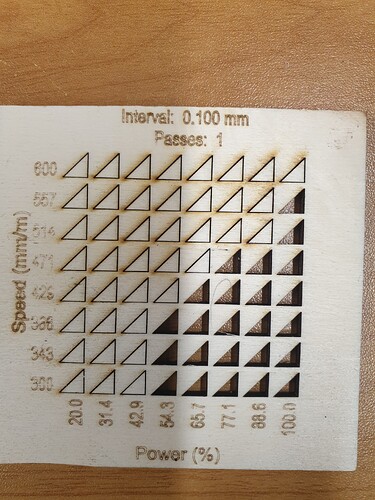

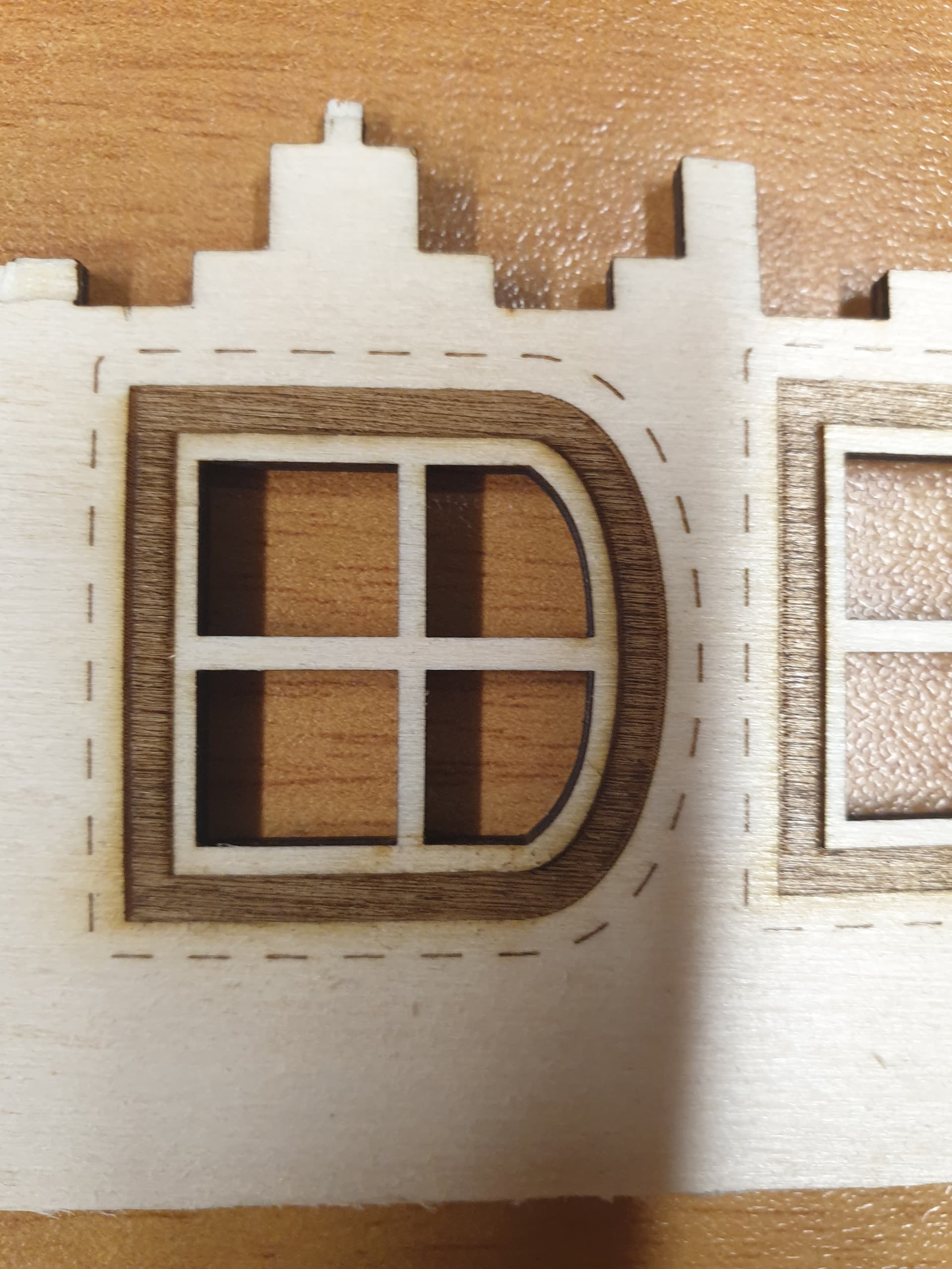

I recently purchased a new 20W XTOOL s1 laser engraver and I encountered a problem while testing the materials: instead of cutting squares, as per the preview, it cuts triangles
If this anomaly were limited to testing only it would not be a problem, unfortunately this also happens during project processing
I noticed that this anomaly occurs when the cut feature is after the fill feature.
If I do the cutting first and then the filling there are no problems
If it helps to better understand the cause I can send the .svg file
Thanks in advance for your help
Fabio
