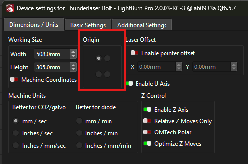

In your device settings, under the Working Size, you’ll see 2 toggles:
  • CNC Machine which is to be turned on if your machine is in the negative coordinate space (i.e. MPOS 0,0 is back right, but moving left or forward is still a negative X or negative Y move)
  • Machine Coordinates which will basically discard any use of the G54 offset and directly work in G53 coordinates.

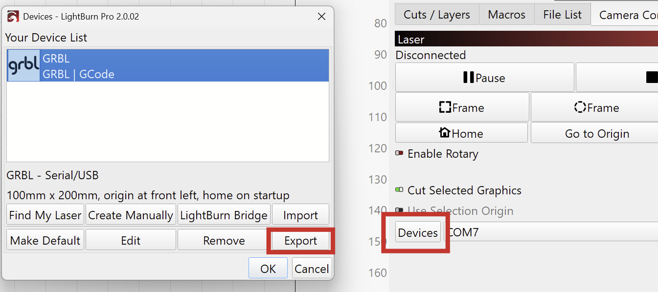

Click the ‘Devices’ button in the ‘Laser’ Window, select the device, and click Export:

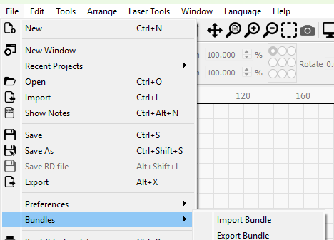

@Aaron.F nope - please use File->Bundles->Export Bundle for that - we would prefer the .lbzip instead of the .lbdev file moving forward.

Where / how are you changing this? Screenshots would be fine.
Normally this would be changed in the Device Settings by selecting the proper device origin, not in the Machine Settings which would affect the GRBL configuration.

Normally you should be able to use origin top right with the CNC machine toggle on and G54 reset for LightBurn as well.
The G54 offset would need to change for every work piece you’re clamping down to cut out with ugs anyways, so if we find the settings so you just need to reset that part to 0,0 I think that’d be the best solution for you.
