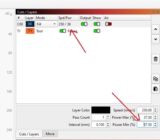

I installed 2.0 on what I call my design PC (no laser connected) and discovered that, upon opening a previous job, the power settings were not responding to what I was typing in the Pwr Max and Pwr Min boxes (see screen cap). I’ll leave the PC’s running my lasers on 1.07 for now.

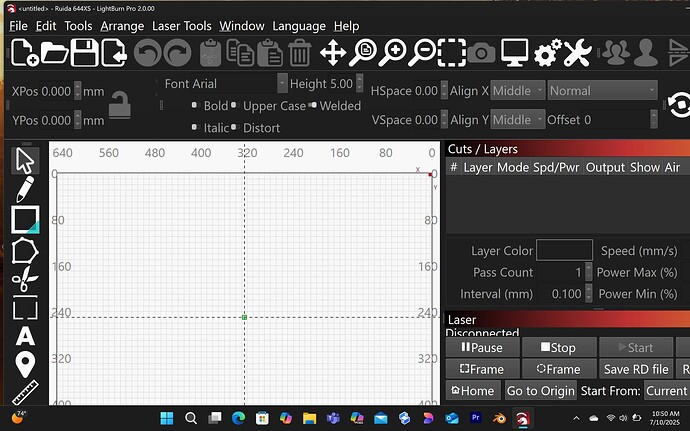

2.0 has made lightburn look like a child designed it, and no longer fit my screen…how do I change it back?
Um, thank you for your, well, feedback. If you are willing, are there specifics you can share?
Please share, what screen size are you working with?
If you are asking how to restore the layout to fit your screen, share a screencap of what you currently see.

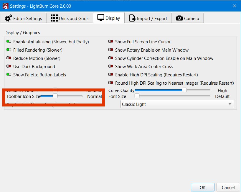

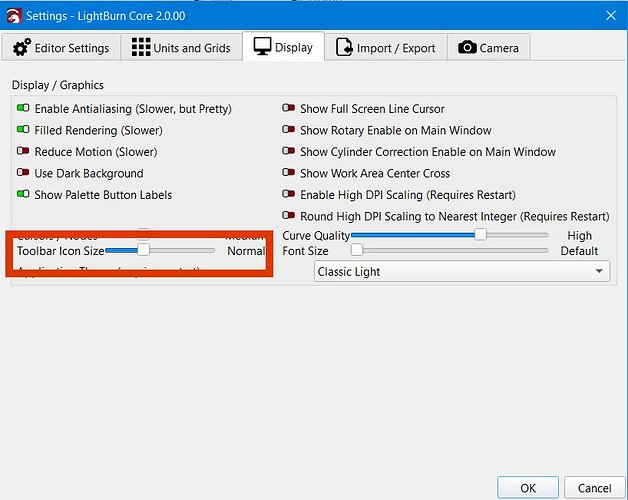

I assume this is dark mode, which it won’t change? How do I shrink the icons? my 14" screen, I want the greatest design space.
Many thanks
I knew it would be my stupidity!!
Thank you

Mea Culpa, what I perceived as an issue with the software turned out to be the fact that if you enter a half percent value in the Pwr Max, Pwr Min boxes, Lightburn will now round up to the next whole number. The UP/DN arrows still changes the value in 2.5% increments, but the Spd/Pwr block will change to the next higher whole number. I will be familiarizing myself with all the new changes in 2.0.
Any idea on how to get it to fit my screen?
This may be what you are experiencing, worth review. :slight_smile:
