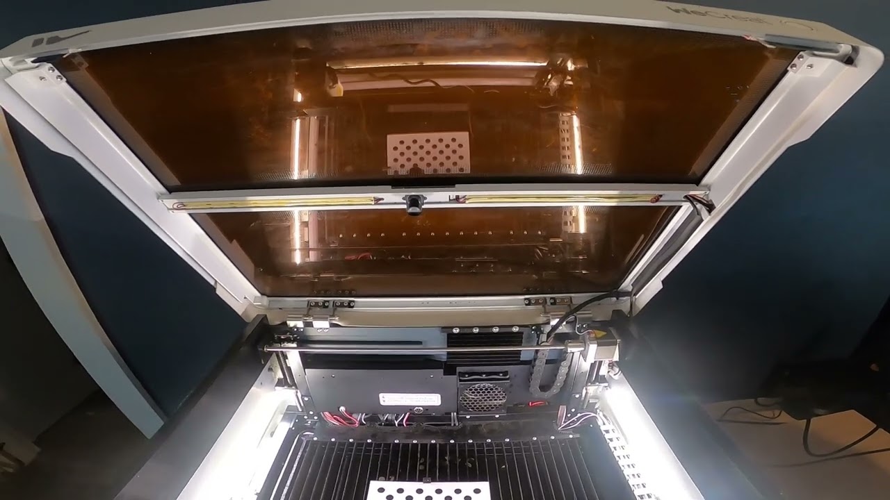

Figured out how to use the WeCreat camera in Lightburn, but it’s not for the faint of heart (or those worried about warranties);
Using WeCreate Vision Camera With Lightburn, and Why You Shouldn’t
totally a self-plug here but a less invasive way of using the camera:
