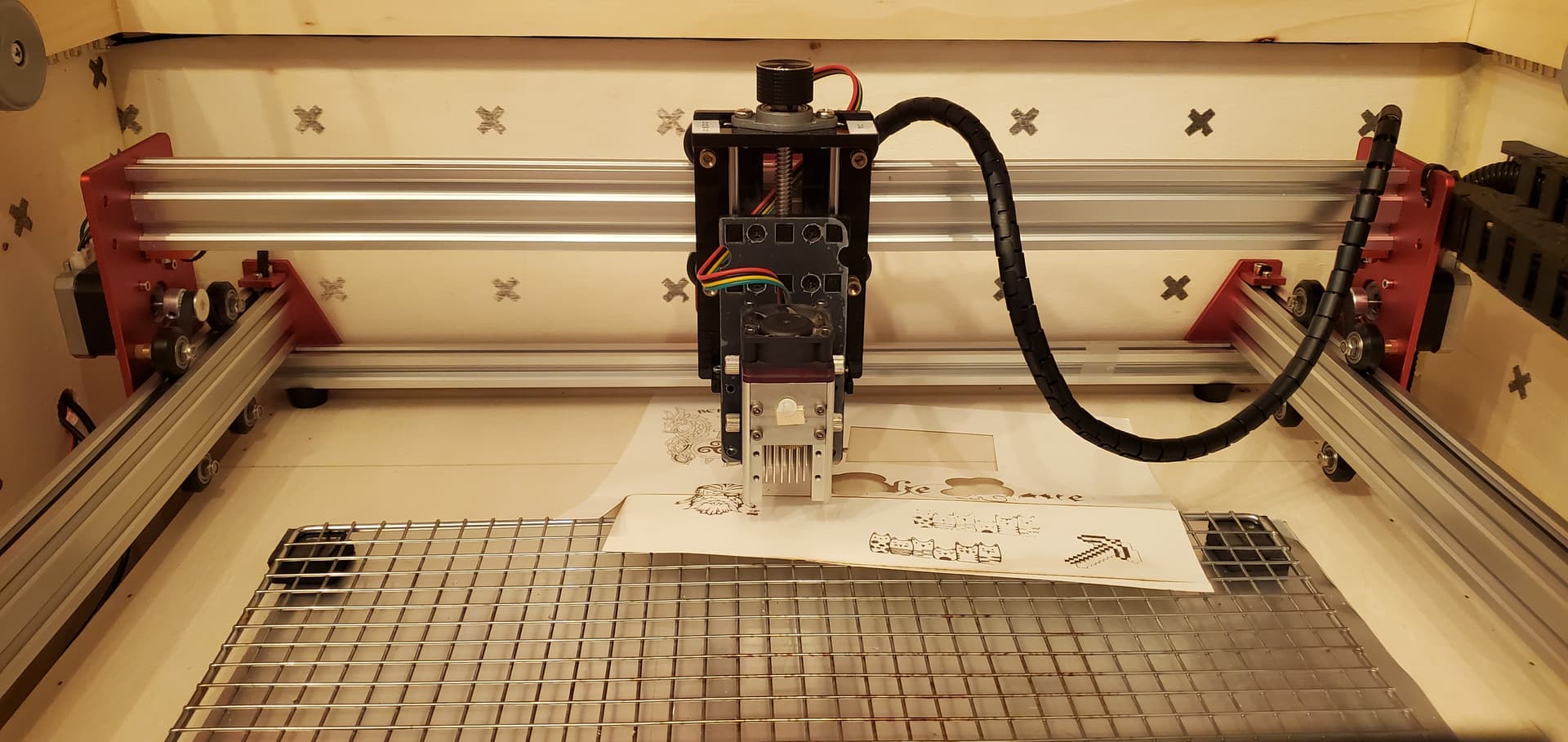

My machine works well overall. (GRBL 1.1). If I draw a circle, and use the “square frame” option at 50 mms it’s smooth, if I use the “Frame Circle Option” for tracing … it jitters. If I slow the Movement to 20 it’s smooth.
Here is the kicker, when I burn I can run at ANY speed from crawling to maximum and it’s perfect … it’s ONLY when I use the “Circle Frame button” at speeds higher than 30mms.
Is this a software glitch.

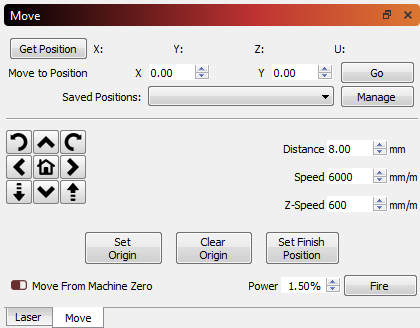

If I hover my cursor over Frame - the info box refers me to the jog / position Speed in the Move window. What might that setting be for you?
Regardless, 30mm/s is 1800 mm/min and that would be pretty fast for a lead-screw driven machine. What is the Model Number of your 40W Neje Engraver? I want to find a picture of the layout and drive mechanism.

I have an X, Y1, Y2 setup. I have set Move to 50mm/s and then tried cut at 50mm/s … the cut is smooth the “frame” jitters … just with a circle. Weird !
For the record there is a stepper behind the laser for the X axis
So three steppers.

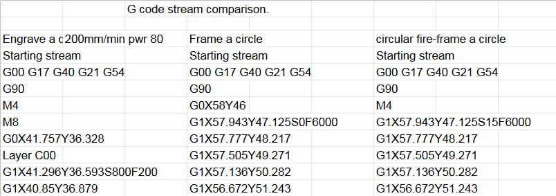

I’m going to engrave a circle, frame a circle, and laser-on-frame a circle and dump the g-code streams from each of the three ‘jobs’ to see which travel modes are applied and if/how accelerations are called.
Although I could be way off in the briar patch, my current line of reasoning is that the difference between the engrave speed and the maximum speed could be causing or calling for the engraver to accelerate and decelerate in some travel modes. I should see different information; move, travel speed, spindle speed (laser output) between the three streams and i should be able to see what’s being commanded.

and… i have an answer that i wasn’t expecting.
M4 turns on the variable power spindle feature it’s in the first and third column only.
roll down to the first line with a G1 operation:
S800 is 80% power (80/1000) s0 is 0% power and S15 is 1.5% power (15/1000)
The number of moves while framing in a circular way are about half as many so the circle the same size but more coarse. The four vertexes are in the exact same places.
Also in that first G1 line are F200 was my feed rate in mm/min but the framing operations were called to feed at F6000. My $110, $111, $112 are set for 800, 800, 600 respectively
I took a few minutes to look around for the 6000 that the machine used for framing. It’s in none of the machine settings. It is in the Move window.
2022-02-05 move window says 6000
I wanted to prove that’s where it got the 6000 from so i changed it to a random oddball number 2973
circular fire framed again…
Starting stream
G00 G17 G40 G21 G54
G90
M4
G1X57.943Y47.125S15F2973
and there it was.
So, my answer based on a quick investigation is that yes, the engrave speed and machine speed limit are both separate from the framing Speed which is equal to the move Speed in the Move window.
I’m going to have to try a series of move operations with a stopwatch to see how fast the controller can operate the stepper motors. I do not believe that my engraver travels that quickly (for framing) as the G-code command asked it to. The GRBL controllers have some kind of upper limit based on hardware limitations in terms of clock-cycles per second.
What is the number next to Speed in the Move window? :smiley:
That may be what is causing your jittery machine.
