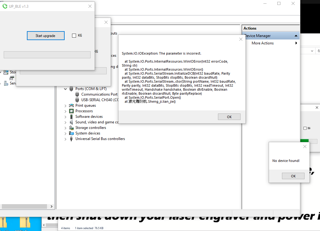

Ok I said ME put in LaserGrBL which I did but this time I get the message
I have tried 3 computers so far and I get the same results I would like to toss the control board and install the type of board that the 3018 uses I think the name is wood pecker as it does have a laser.

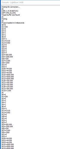

The third step is confirming that the requested laser or spindle power is being requested on the same scale. The value assigned to $30 in Machine settings has to match the value assigned to S-value max in the Device settings
Please report back if $30 and the S-value max aren’t the same value.

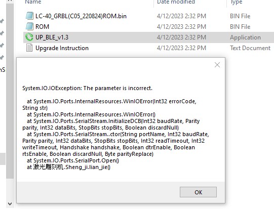

Let me ask this what does this mean
paramater is incorrect2023-05-05 095401

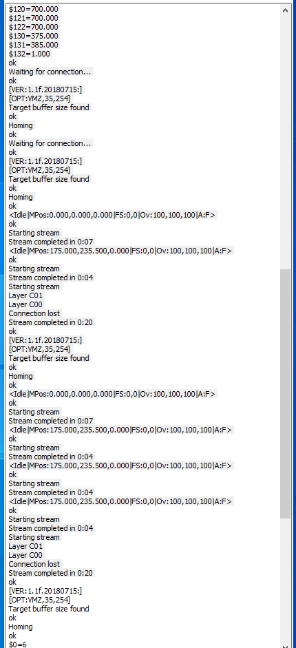

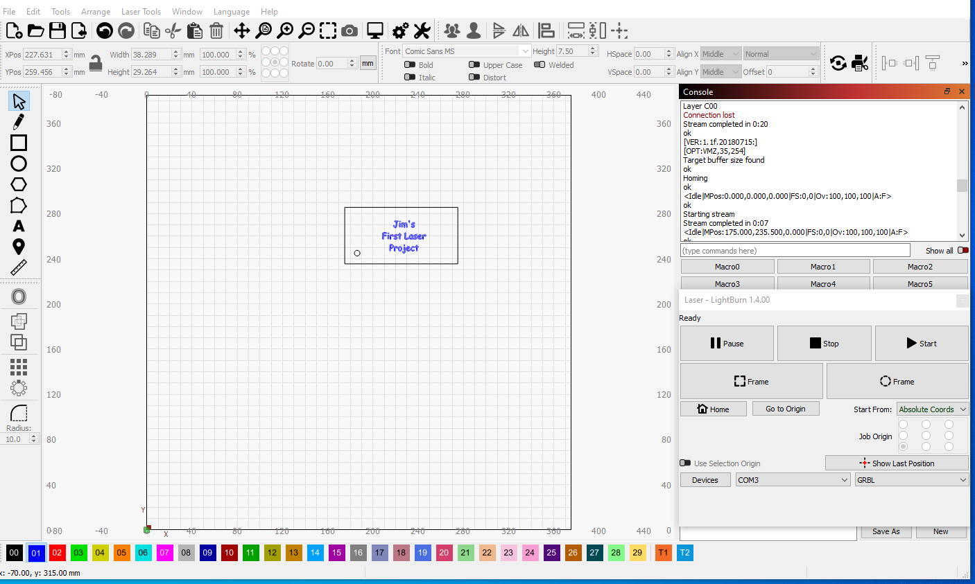

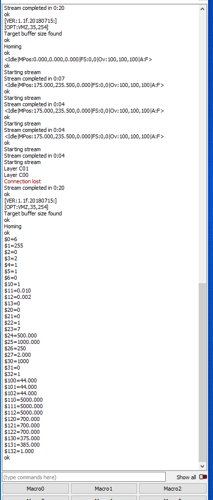

The machine will Frame and it comes to a resting point on the lower left of the project but when I press start it moves to the lower middle making a few burn marks and quits and this message comes up.

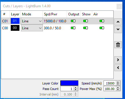

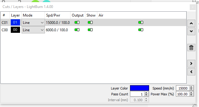

I followed the video instructions to the letter yet when I hit the start button the machine (software) will not complete the job also the laser does not want to burn anything including paper I have included screenshots of the key chain from running the framing tool to the cutting /burning of the project, I have two videos of the laser framing and cutting and after it stops it will home itself, I do not think it is supposed to do that in GRBL but I do not know how to see which firmware is installed, also the 341 driver is installed and working.here is the video I took of the laser framing and cutting follow the facebook link Redirecting...
Below is the screenshots from the operation.

This is the firmware installed and is definitely GRBL:

Can you take a full screenshot of LightBurn with the Cuts window showing?

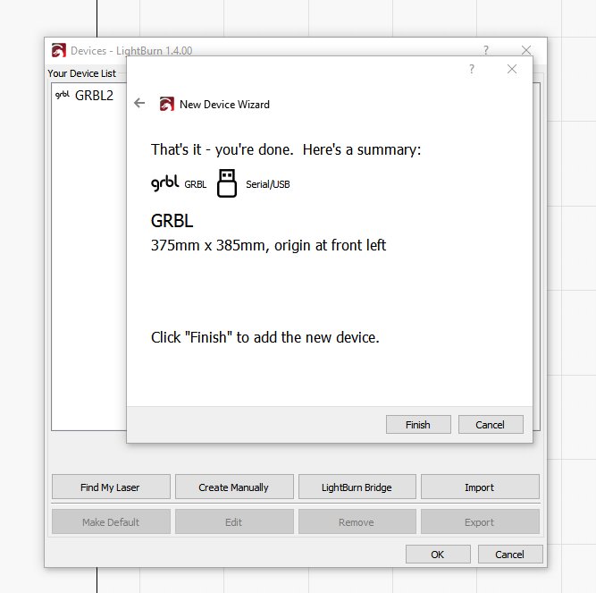

Also, please take a screenshot of Edit->Device Settings.
Can you elaborate on what this means? What exactly happens?

Device Settings

Try dramatically slowing down the speed. Keep slowing down until a mark is made.

Dramatically slow down the Cut setting speed and try again.
I was able to see the framing video which looks fine.
Note that the machine is likely not homing at the end of the job. Just returning to that position which is set in your Device Settings “Return to Finish Position” at 0,0.
I’m pretty new to all of this as well, but isn’t 700 really high for the X Y Acceleration? Mine gave me problems at 100.00 so i had to bump it down to 50.
I’ll assume the default configuration from Sainsmart is at least somewhat tuned for the machine at least for now and I know that others with the same machine are running with default configuration at least in some cases.
