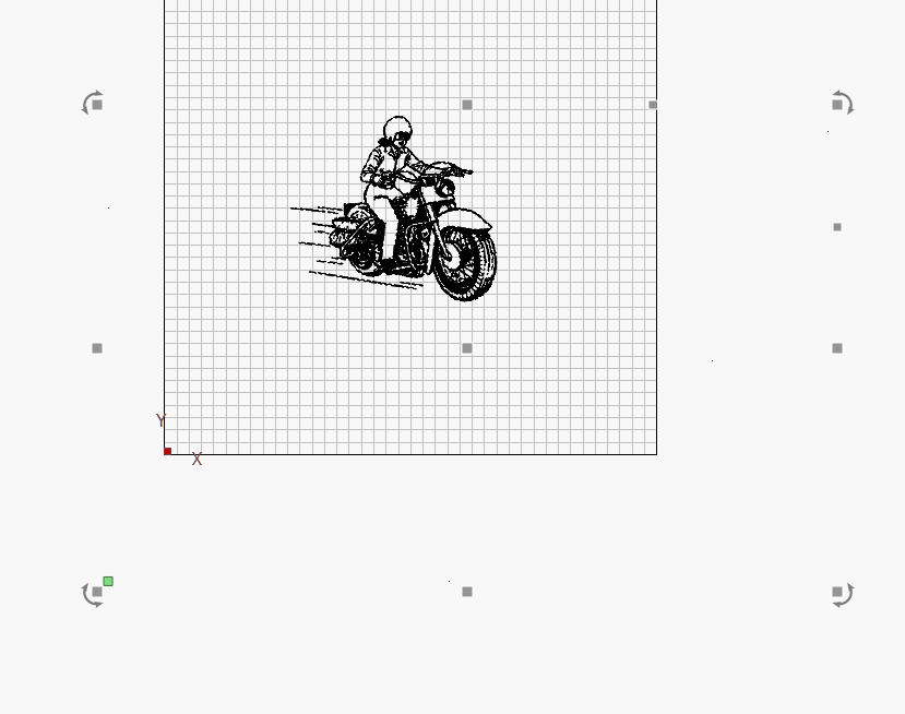

6. QR CODES with images in Lightburn another world first .
(easy if work with menu Window > filled rendering)
A)
Create your QR Code setting Error Correction Level to Very High and type your texts.
B)
Between each step do 1 or 2 duplicates and put aside as a backup so that you don´t have to start all over again.
.a)Select your Image.
.b)Do a rough but complete trace of your image (remove traced text) select all shape and menu Arrange > Create rubber-band outline from selection set to another Cut/Layer (color orange).
.c)Node edit the Rubber band(orange) to obtain a shape near the traced shape.
.d)Duplicate and drag the Node edited outline shape (orange) duplicate again and put aside.
C)
Place the outline shape aligned with image, select both, right-click select Apply Mask to Image, right-click Flatten Image Mask .
D)
Select the before duplicated outline and select the masked image and align both centers image and “rotate” per your final position .
E)
Select the outline orange shape and place in place.
F)
Set the outline shape (orange) and the QR Code to Fill mode.
G)
Select both shapes or Boolean Assistant (Ctrl+B) then place the image in situ.
Click to see QR Codes, use your barcode app to check
(This points to import contact)
(This one points to URL)
(All made with Lightburn)
( the place where you place the images or bigger images can mess with code integrity, always test)

QR Code update.
Wiping out those squares will definitely mess with code integrity. Your example QR gives me a bad URL even before the image insert. It would have been nice to see a working example.
Tested with my mobile app and a few online and it works.
MECARD:URL:https://www.edmundoptics.com/knowledge-center/trending-in-optics/ultraviolet-lasers/;;
This is what I get without and with the graphic. It does not give a working URL, but I admit you never said that it did, just that it did give a URL.
Obviously, the graphic did not impact the text in this case, and that was my main concern. I had no idea QR’s were that robust. Thanks!
lmao, reserving rights to create content or even speak of using a tool in a piece of software you didn’t write is a new one. may wanna rethink that!
QR codes on the highest error correction level can lose 30% of the bytes and still be usable. take a look at qart (from 2012!) for a more robust implementation of cool qr codes. QArt Coder
That is definitely impressive. Thanks for the link!
