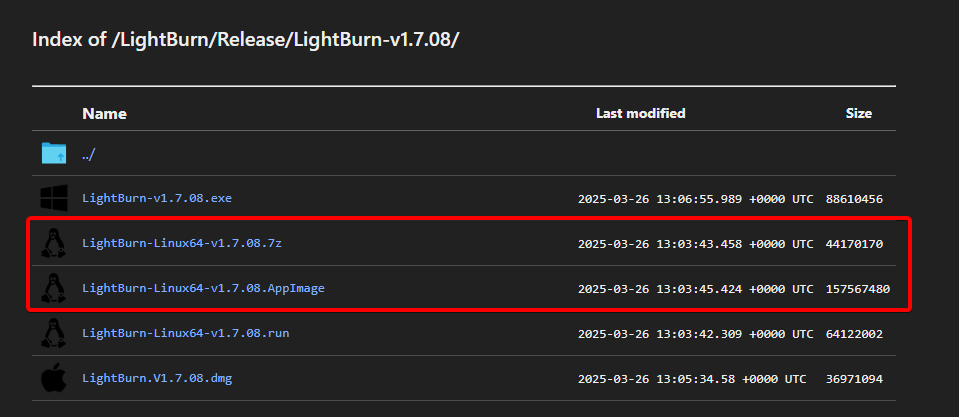

Tobias is right, 1.7.08 has a native build for Linux.
I used the 1.7.?? Windows version.
1.7.08 has native Linux installers
No need to use wine or windows.
That is only true if one doesn’t want updates of LightBurn anymore (since the Linux version is no longer maintained).
My neighbour is interested in (paid) updates, but cannot use them, because they currently seem to not work with wine.
Now, if the licencing issue is really gone, then looking into up to date Windows releases of LightBurn makes sense for having both, updates and no Widows installation.
