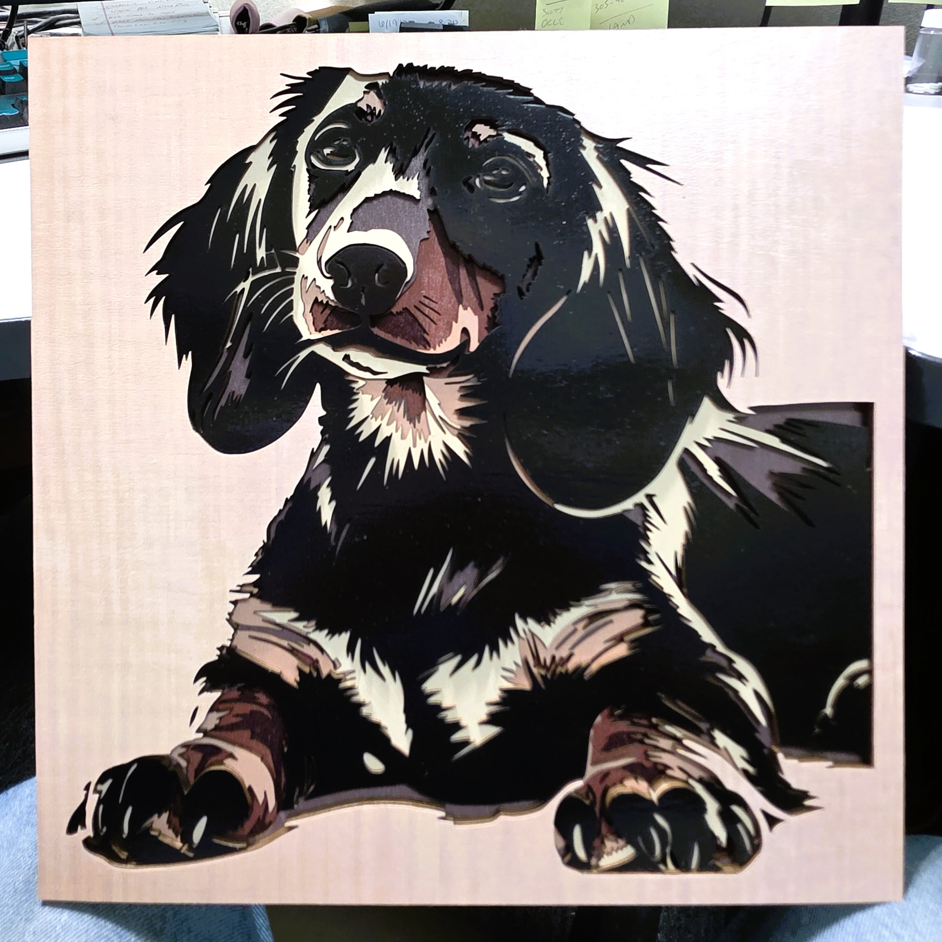

Thought I’d show the inner layer of the new frame design,
there is an inner panel with an outter small 10mm frame that is the same size as the back panel.
the top ‘L’ outline frame fits on top of these two,panels..
Makes it easy to cut as the middle layer serves as an alignment frame that gets glued to the
back panel then after UV printing the picture on the inner cutout piece, it drops back
inside and gets tacked glued before the top ‘L’ frames are glued in place…

That flatter style looks pretty cool chuck.

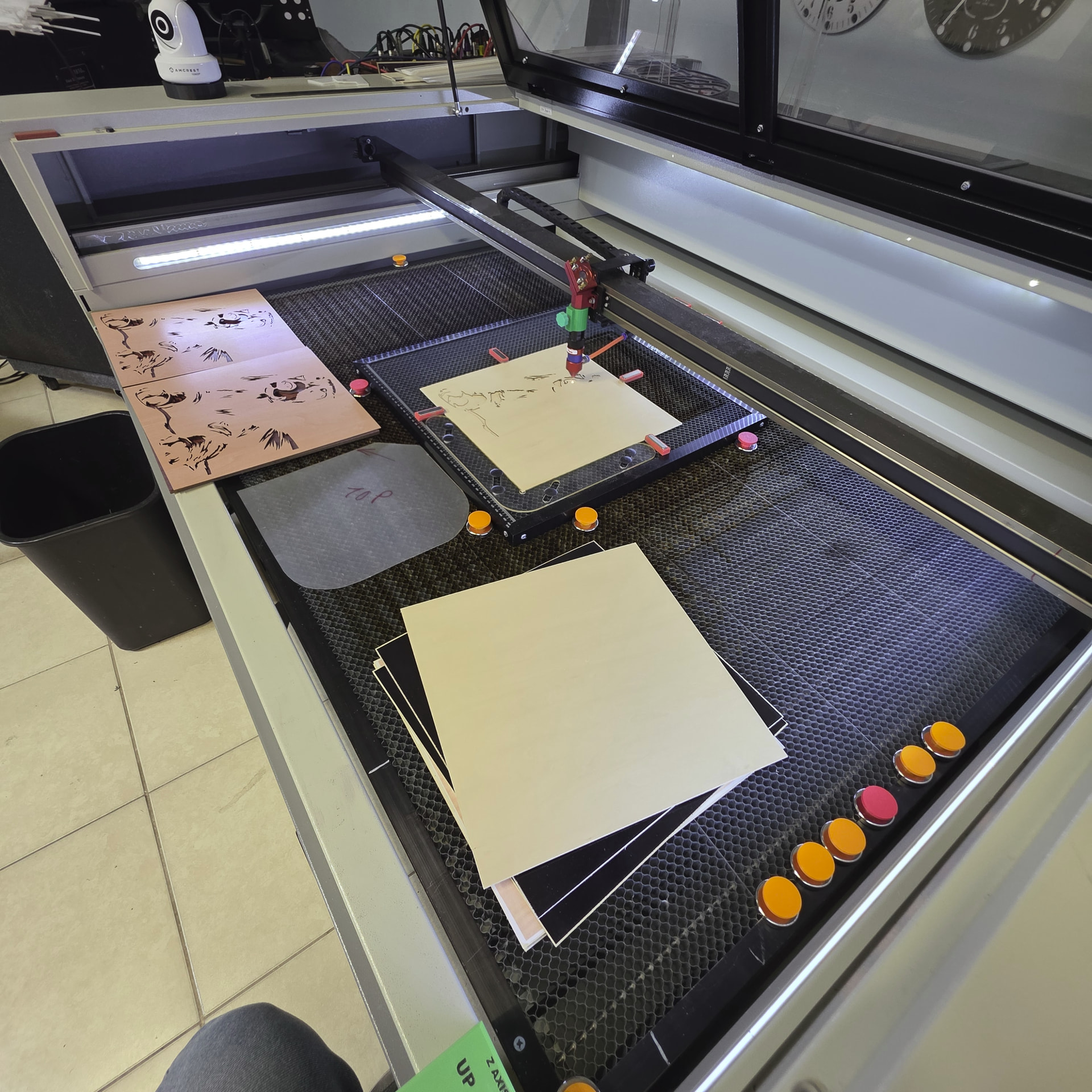

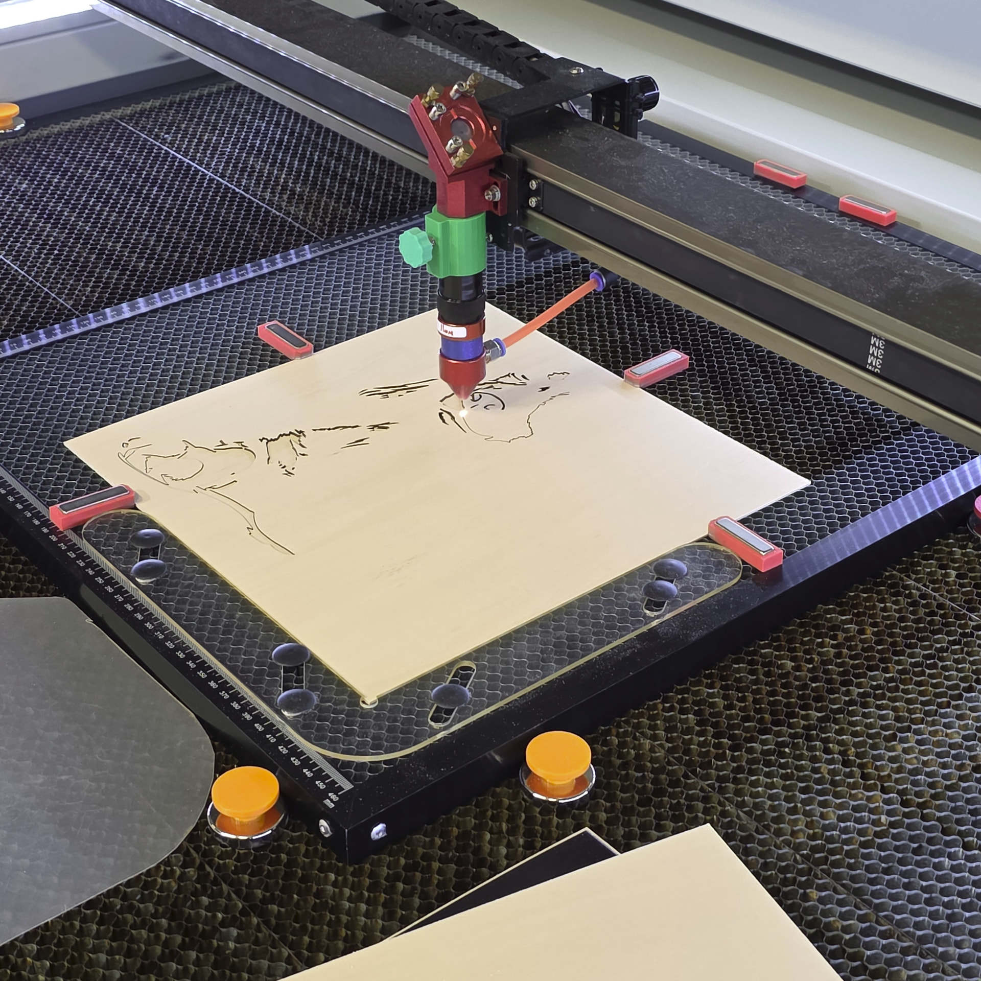

Chuck. In the picture, is that big acrylic sheet on top of the main honeycomb have a cutout to receive the small honeycomb, all to help with airflow and smoke extraction.
The large area bottom honeycomb is 1300 x 900
the smaller top honeycomb is 460 x460 that I drop in place when cut 300x300 sheets
then remove and store off behind the laser… I keep the Acrylic right angles attached
so it is easy to drop in and align the wood sheets for cutting, just lower the the bed a little for head height and the air exhaust can pull thru both honeycombs when cutting,
There is no top acrylic sheet…
