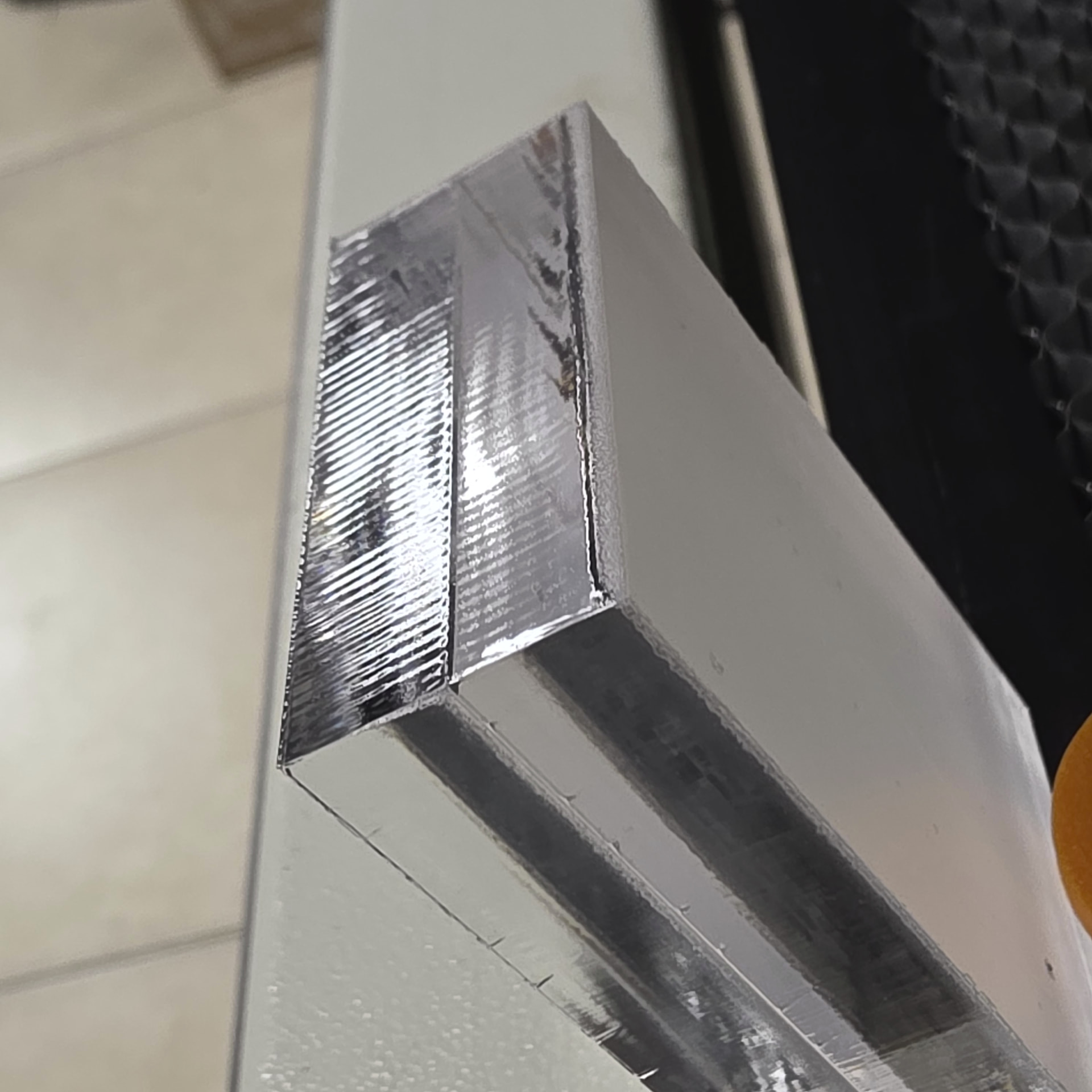

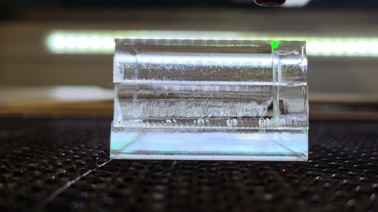

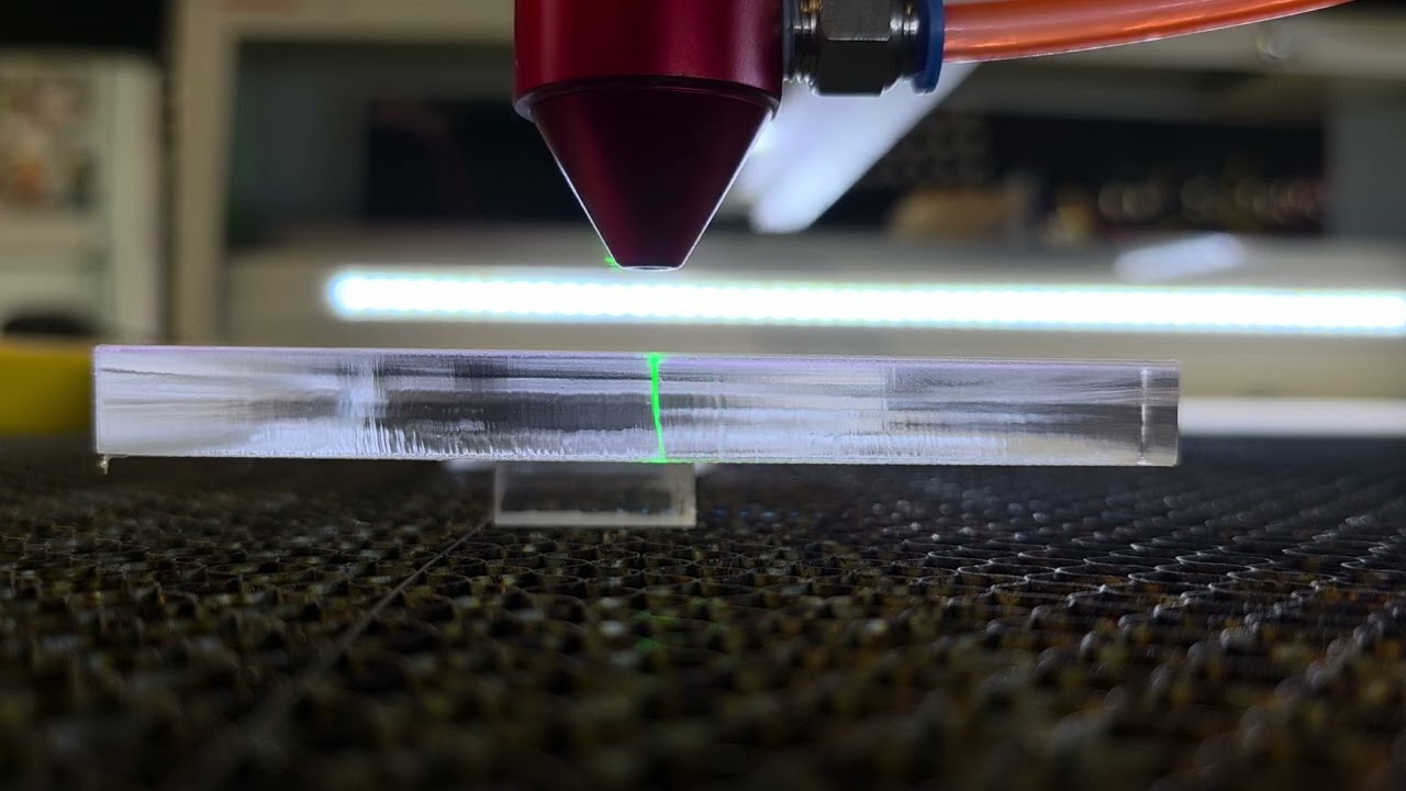

Come to think of it, unless you’ve dramatically reduced the controller’s Start Speed, running at 2 mm/s may be throttling the power to-or-below the Min power setting:
Those videos clearly show the “beam dragging” effect: the bottom part of the cut happens well behind the beam position, due to the acrylic not vaporizing instantly and the gases doing the cutting.
