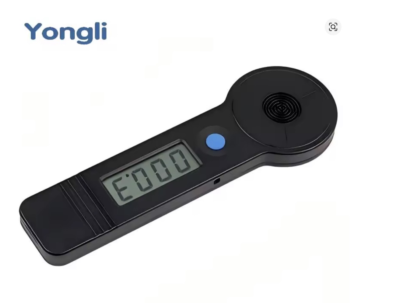

I usually check power off mirror 2 as it is convienent, but this time I took the lens tube off
and used my Yongli HLP-200B meter to ck the power.
so with all three mirrors in the mix as well as the beam combiner…
the power set to 50% the meter measured 68.5w the tube is an A6S Yongli 130w

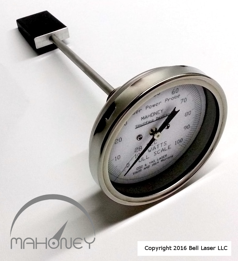

Do you see the same pulse-to-pulse variations I do, even with the meter held in exactly the same place every time?
I only did one shot at the far right front, furthest laser point…
Generally if I do multiple readings I use the Mahoney meter…
with a bucket of water at room temp, I can cool it back down quickly for another measurement…
not sure how the HLP-200B cools down and is ready for the next shot…
seems a bit uncertain… I f you have info pls let me know…
I see the cooling aspect of the HLP-200B a weak spot, as I said how do you ensure you start each measurement at the same starting temp.. ie. suppose to me ambient temp.
It’s air cooled and will warn you when it gets too hot; apparently the microcontroller compensates for the starting temperature.
Which makes sense, because the temperature increase for a given pulse energy should be roughly constant at any temperature you’d be willing to hand-hold.
The Mahoney’s fixed scale doesn’t allow any of that, so the sensing block must start at a known temperature to put the needle at the right place after a pulse heats the block.
Kinda thought this is what they did… so the additive stored heat is just calculated out…

Actually the testing I was referring to was the repeatability of the HLP-200B, with unchanged variables…
Just to look at the cooling aspect and the units ability to calc the additive heat component from each previous test. I suspect that room temp, air flow, and actual time between tests are all to be considered to have each test to test compare accurately…assuming battery, position, co2 tube cooling cycle all remain constant :laughing:
un less you can assume that the cooling effect between shots are compensated correctly in firmware… and do not not have a exponential component, that could be considere, but I DOUBT IT…
then this is what the test would be looking at in the first place… so the controlled environment should be critical to get a true analysis…
but then… unless a couple watts really matter, the exercise merely academic… :slight_smile:

That’s pretty much the table I showed in the post, with the error bars being ±1 standard deviation:
The temperature rose about 3 °C and IIRC it had to cool before taking the last series at 99% PWM.
Eyeballometrically, any given measurement is within 10% of the average, which is probably OK unless you’re trying to hit a particular power or measure a particular change. If you really care, the average of half a dozen pulses would be more confidence-inspiring.
Most likely, it just measures the temperature rise, with the overtemperature alarm ensuring the absorber / aluminum case doesn’t get absurdly out of range.
AFAICT the samples in that table show no trend between the starting temperature and the reported power.

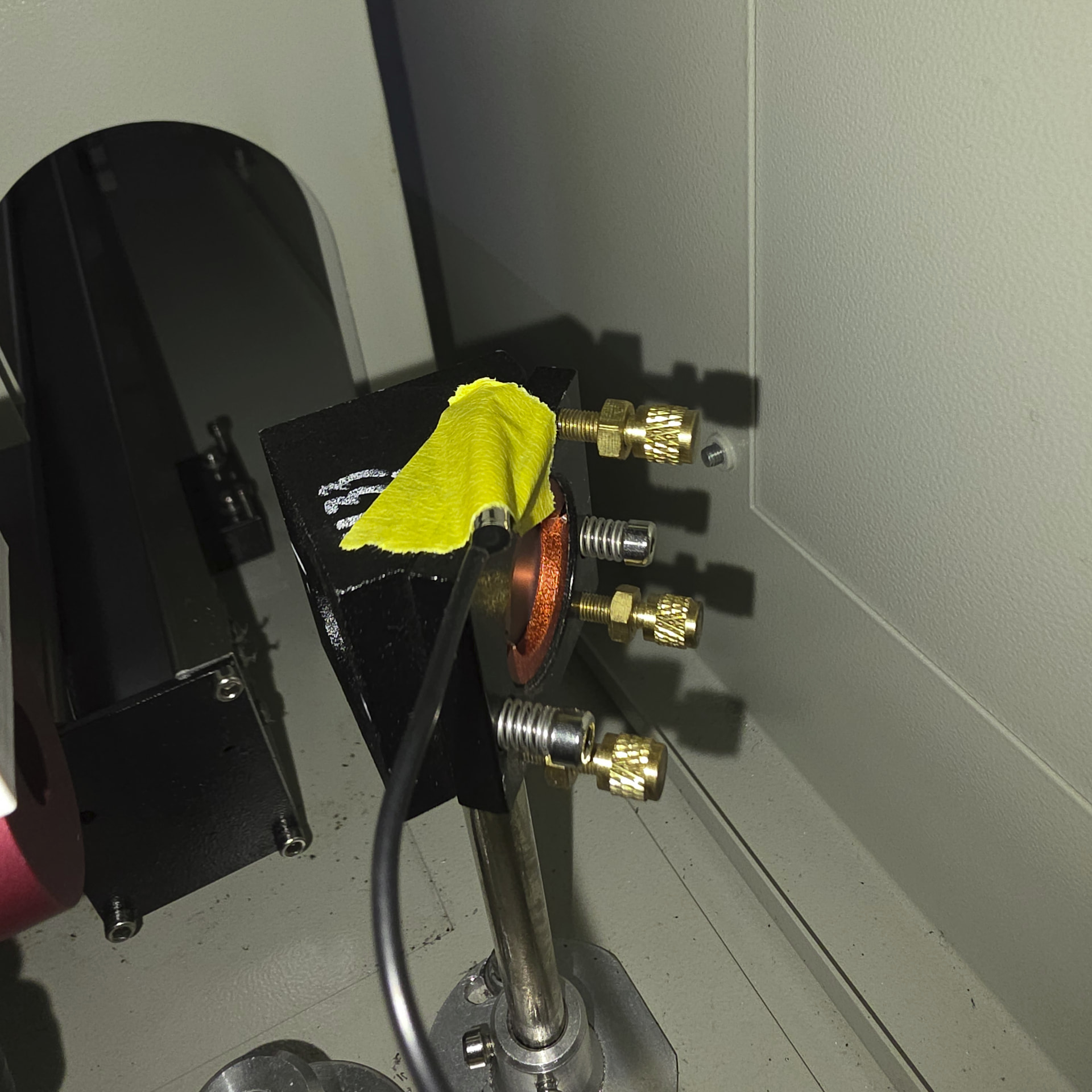

This is the Temp sensor I have on Mirror 1 to monitor the heat transfer…
Hopefully when the mirror starts to wear, as it did, the temp should start to rise and I can
catch it before it impacts cutting too much..
Just taped it on right now, may figure out a screw attachment at some point when I need to change them out again…
Cut the American Eagle Layered wood and the temp was sitting between 88-90F so I guess this
is the base line with the new mirror…
The cloth above the probe helps insulate the sensor from ambient temperature, but I would say it’s not enough.
Still, I would always take ambient temperature into consideration.
Since the lens mount is made of aluminum (or metal) and is exposed to ambient temperature, this temperature will be conducted to the probe, always affecting the reading.
Overall, I consider it a good upgrade in terms of preventative maintenance.
:+1:
it is actually a piece of yellow painters tape, I use it for everything :slight_smile:
all your comments ‘spot on’ and since the room stays between 75-79
should be just fine ..
I know when I noticed, with my hand a few weeks back, that the mirror had gone bad, it was VERY
hot after cutting..
today if went up to 90 then dropped back to 88.5 and hung there for the remaining cutting time..
all fun stuff…

the mirror #1 was worn, had to be from use, as the coating looked as if it were wiped off
and I’m sure the reflectivity had been reduced significantly..
Last year when I spoke with Lou (now retired) at Amercian Photonics here in Florida, he mentioned in passing that he replaces his CO2 laser mirrors every 6 months…
Well that little nugget if info went to the side and time quickly passed when I realized
my laser cutting power was dropping…
So the temp guage can hopefully keep the mirror inspection oversight at bay…
but the 6 month reminder on my calender will also help…
And as part of my monthly routine I will grab the HLP-200B power meter and do a quick ck and log it as I go..
