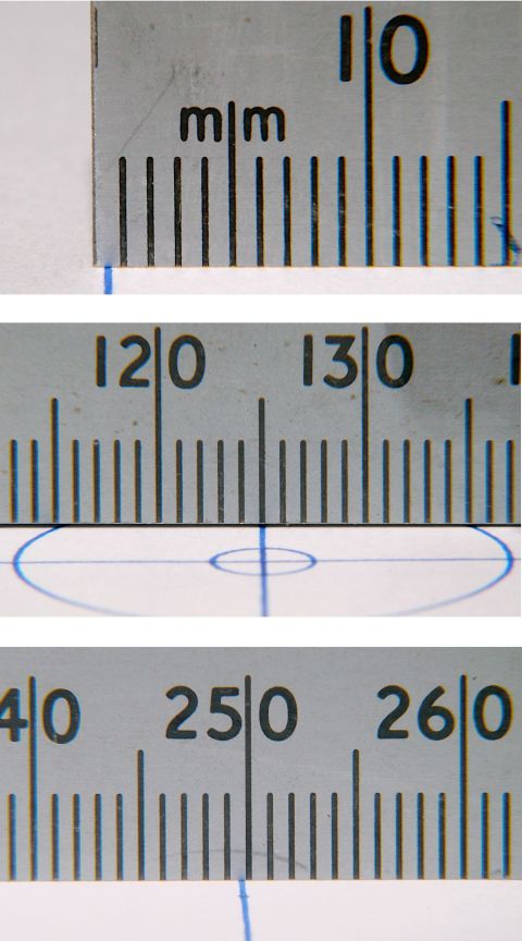

Opinion: folks who tell you to calibrate the axis based on cutting any material do not know what they’re doing. Engraving vector lines is OK, but it’s even easier than that.
Instead of wringing your blocks, deploy the longest bestest engraved metal scale from your armory:
Align the scale parallel to the axis, align the laser (with its red dot pointer or test pulses) at a convenient division, jog a known amount, and see if the beam is dead on where it should be. If not, tweak as needed.
In principle, the step/mm (mm/step or µm/step for Ruida controllers) is not amenable to tweaking. The stepper driver gives you the step/rev, the pulley gives you belt teeth/rev, the belt pitch gives you mm/tooth, and there’s nothing else to know.
I am unconvinced the tweaks mentioned in that blog post meant anything, but at least I confirmed the machine is calibrated well enough for all practical purposes.

Nope. IIUC, you’re measuring fine engraved vector lines, presumably center-to-center. :+1:
Which would be my second recommendation, because accurately measuring the distance between two lines is more difficult than reading the same distance directly from a scale. With the lines on the ends of a long axis, you may as well just use the scale directly.
Sometimes, though, you gotta do what you gotta do:
That was how I learned the leadscrew thread was cut incorrectly, requiring a 401.28 step/mm value instead of the nominal 400 step/mm. If I hadn’t been there myself, I would not have believed it to be possible; thread cutting is not a dark art in this day and age.
