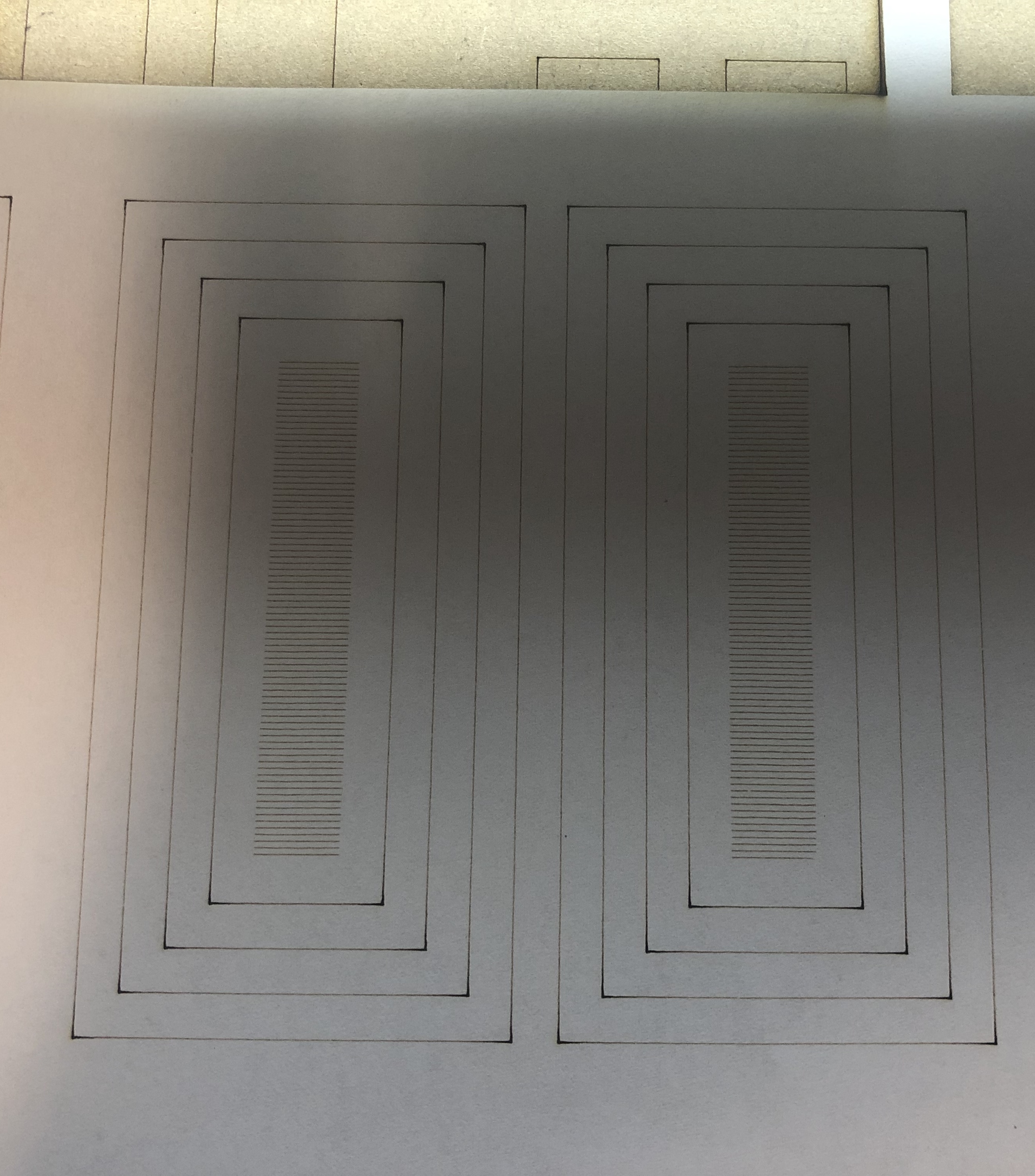

Here is the engrave in the middle and then cut rectangles around the engraved rectangle
You can see it’s not a simple shift in alignment from the engrave to the cut it looks like it’s getting worse as the engrave continues(possible slipping but only when it engraves at higher resolution)
Also I slowed the machine down to as slow as 300 and it’s the same results as the original 3000mm
I checked backlash but that didn’t help and my line scan offset is perfect at 0.8 but the finer I get the more it skews
I’m lost and I’m sorry my technical terms/speak is that of a noob
Cheers
Is this a new machine? If so, check everything mechanical first. Make sure everything is tight, including (especially) set screws holding the belt pinions in place. If those slip a little every time you change direction, it wreaks all kinds of havoc.
