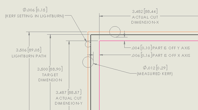

Here’s a part I cut with the machine as received. It is a 3.5" square quilting ruler/template. I had just received the machine and did not have much cut data documented at that time, so my kerf setting was off. The Kerf setting is in lightburn was set to .006", but the actual kerf measures .0115". Obviously due to the wrong kerf setting, I can expect the part to be off, but it is off more than theory suggests it would be. hopefully this picture clears things up.
part cut vs theoretical dimensions
Again, this is how the machine was cutting as received. The positional accuracy was listed as .01mm( .0004"), so it is off by 15x (x-axis) and 10x (y-axis).
Any kind of test file I cut with this machine with it’s original settings is going to be off, so I don’t see any value in making those as the machine currently sits.

The kerf setting should be half of the actual kerf, so your setting is just about spot on. In round numbers, a focused CO₂ beam will be about 0.2 mm in diameter and produce a cut about that same width, so, depending on what you’re cutting, a 0.3 mm kerf is as good as it gets.

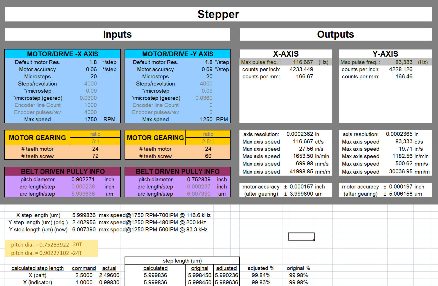

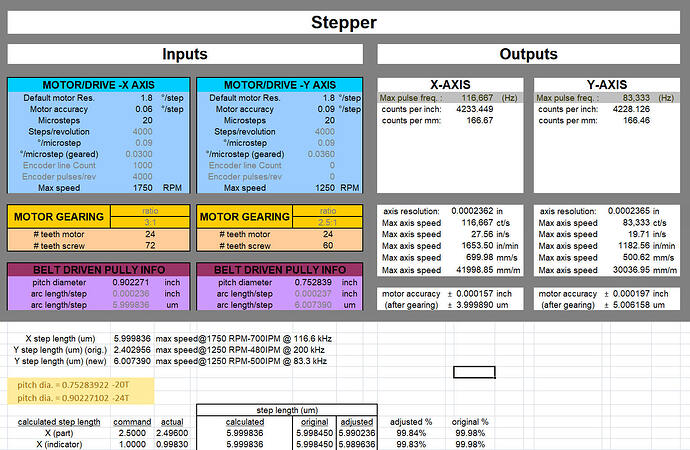

Here’s the values I calculated over the weekend, BTW. The design criteria I recall is the axis resolution should be 10x (or 1/10?) the desired positional accuracy, which should put me in the .0025" range. .008" seems too much to me. I think that rule was for servo’s and ballscrews, so maybe with steppers and belt drives, it may be different. I guess my next steps are to find and reduce the backlash. and take it from there. Appreciate the help on this.
Also, I’d like to mention that I paid 5K for this thing (after shipping), not 3K. There were 3 or 3.5K machines with higher wattage tubes, but I choose this one primarily for the increased accuracy. I thought I was getting closed loop steppers on both axis, but misread the listing, and that is only on the X axis. In short, I paid extra for more precision, and apparently didn’t get it. I hope that helps clear up some of my expectations and frustrations.
Again, I appreciate you assisting me with this. I know this has nothing to do with LightBurn, but it seems to be the best forum for Ruida controllers. All my searches keep bringing me here at least.
