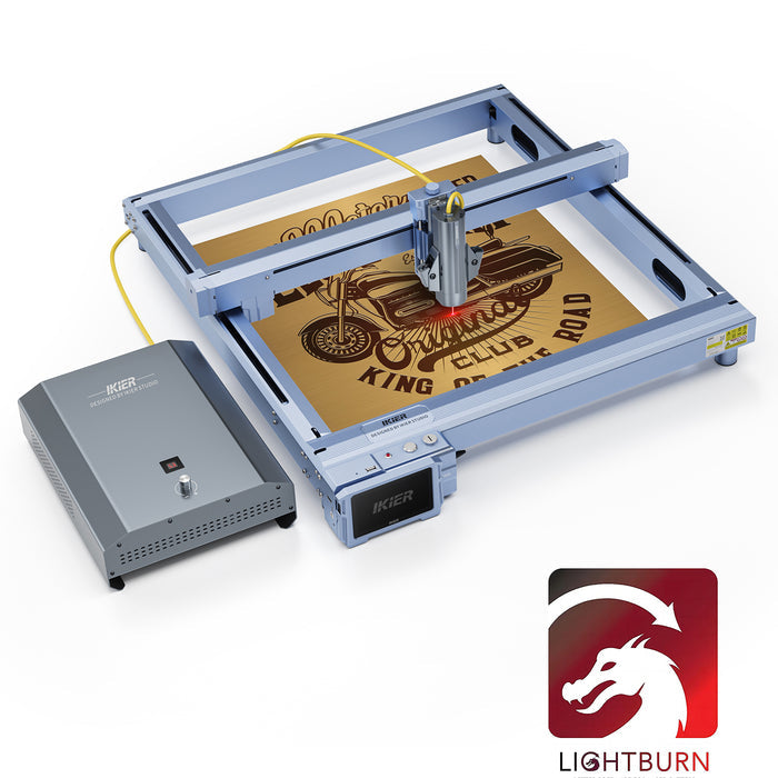

At the and of january I order iKier K1 pro fiber. It come at 10 of february, and work for 10 seconds on 30% power and stop with E3 message on the fiber box. Try to start again with different power- and work 1-3 sec and end up with this E3 error and stop the laser beam.
On 11.02.2025, I send e-mail to support, and they say- the problem is on motherboard in control box.
They send me one, and the motherboard come on 10 of march. Start to test it, and work arround 10 minutes and stop again with error E3. On the video you can see all the engraving I able to make until the laser beam stops. Try different power, and see with more then 40% stops emmediately, below 40% power work from 1 to 20 seconds (randomly).
So I send email again on support, on 10.03.2025 and to this day 28.03.2025 have no solution! Very profesional. Last email from them is on 18.03.2025 and they say- the laser modul seams to have a problem, and need to they leader approves and agree to return the laser modul, they will send me shipping lable. And I wait…and hope the leader to approve returning of the module and maybe replace it with working one soon!

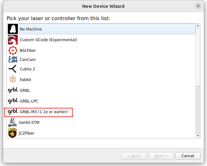

In one of the documents it states to use M3 mode in grbl.
Please note: Engraving vector mode should be set to ā€œM3 modeā€.
Follow the steps below to operate: ā€œCuts / Layersā€ → ā€œLineā€ → ā€œConstant Power Modeā€.
There is a grbl-m3 device when you do the setup…
Did you get some instructions on how to set it up with Lightburn?

Hi, the E3 (error 3) is displayed only on mini display of fiber laser module (where is typical frequency set up with rotary encoden on it). The machine continue the engraved process (but without laser beam to do the job), and no feedback from the fiber laser module to controler.

On the one of my videos on first post, you may see I placed a voltmeter on the controling voltage for laser beam- it stais, but beam is stops, so the problem is on the fiber laser module for me 100%.
