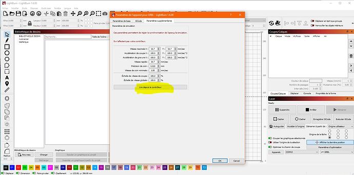

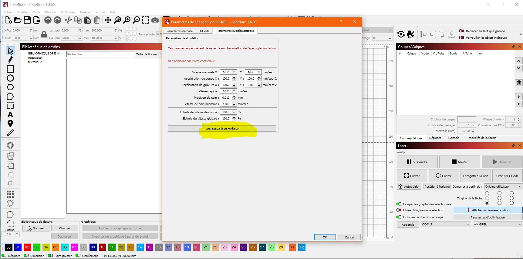

Once the software is launched you must click on this additional settings tab and click read from controller.
It is useful to do this once in a while because the machine, like any other, loses this important data.

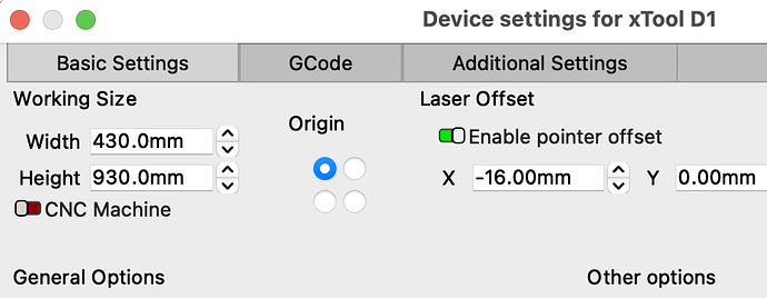

Gents, About the issue with the homing, I have a question for someone that knows the software upside-down: Should we change 131 in this screen to 930?
Then you need a different a .lbdev profile, heres the correct link: Operate xTool D1 with LightBurn - xTool Support Center

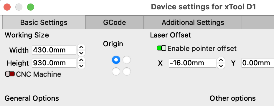

That is the file I am using, and still, 131 stays the same:
406.
I would not change your y axis in your machine settings just yet. Are you following xtool’s instructions? Are they not working for you? The lbdev profile shows the home position being at the top left.

The device settings shows the correct setting unless I change it (that is how I have the canvas at the correct size)

Answering your questions in order: I definetly followed xTool’s instructions step by step, and to be honest, I still do not understand why they request to update the XCS and the lbdev. The way I see this is that if you hook up the XCS to the machine and set it for extension kit, right there is should write the proper data in the control board. At the same time you are requested to download the lbdev, which should do exactly the same. Now to the answers: I am running LB 1.6.00, XCS 1.7.8 on Windows 11. I also updated the D1 FW to V40.30.010.01 B2. I am using absolute coordinates.
Why I think the SW does not know where Home is: (Remember that my device settings are x 430, y 930) On connection the head goes to home (by setting) Using the position icon (Alt-L) I move the head to 308, 535. Now, I click Home the head goes to 0,363. I have to add two more things here: If after the Home taking the position 0,363 I request “get position” it shows me 0,0 instead of the actual position. If from 308,535 I request “Move to position” x0, y0, “GO” then it goes to the real home position.
Red square: It is at all times in the upper left corner, and also the green one.
