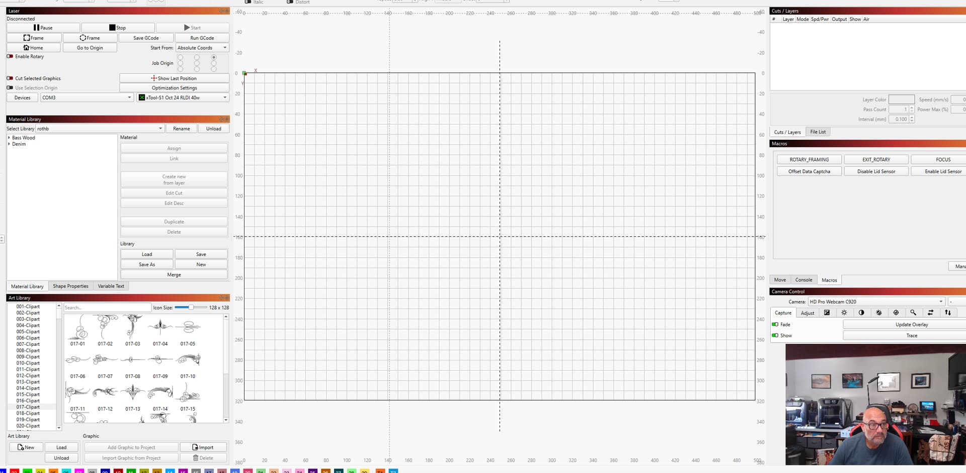

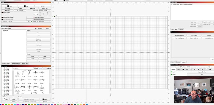

Hello Rick, I’ve just installed the latest RC update and the scaling issues are still a problem. I’ve tried adjusting display settings and the settings within LightBurn, but nothing has worked. Every time I relaunch the programme, all my preferences for toolbar layout, etc, have reverted to default, and I lose the bottom of the window and have to play around with the window normal/maximise button to get the programme to display correctly.
That’s the same layout I get every time I reopen LightBurn. :disappointed_face:

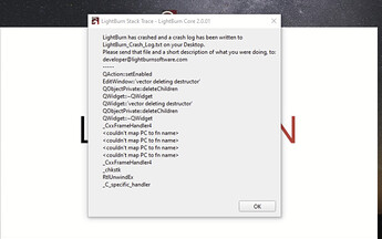

ALL Lightburn versions 2.x.x crash on startup on my Win 11 pro system including 2.0.03-RC3
I have again reverted to 1.7.08 which runs fine.
I am hoping one day this gets fixed and I will be able to run 2.x and see the new features…:frowning:
The splash screen appears then it crashes. Anyone else having this issue?

Do you see a Stack Trace like this?
This mentions a LightBurn_Crash_Log.txt file saved to your Desktop. If you have one, please send it to support@lightburnsoftware.com and include a link to this forum thread.

The last time I was asked for the LightBurnLog.txt file (in my documents directory, none by any name on my desktop) it was determined the application wasn’t getting far enough to create one (it was zero bytes).
When I start the program I get a brief splash screen then it goes away and nothing. I searched my entire system for the current log…nothing.
I submitted the below Event Viewer Crash Error Log. If there is something more I can provide please let me know.

Thank you for your emails and the info that you were able to resolve this by installing the Windows " VC_redistx64" Redistributables.
It is not usually necessary to do this during every installation.

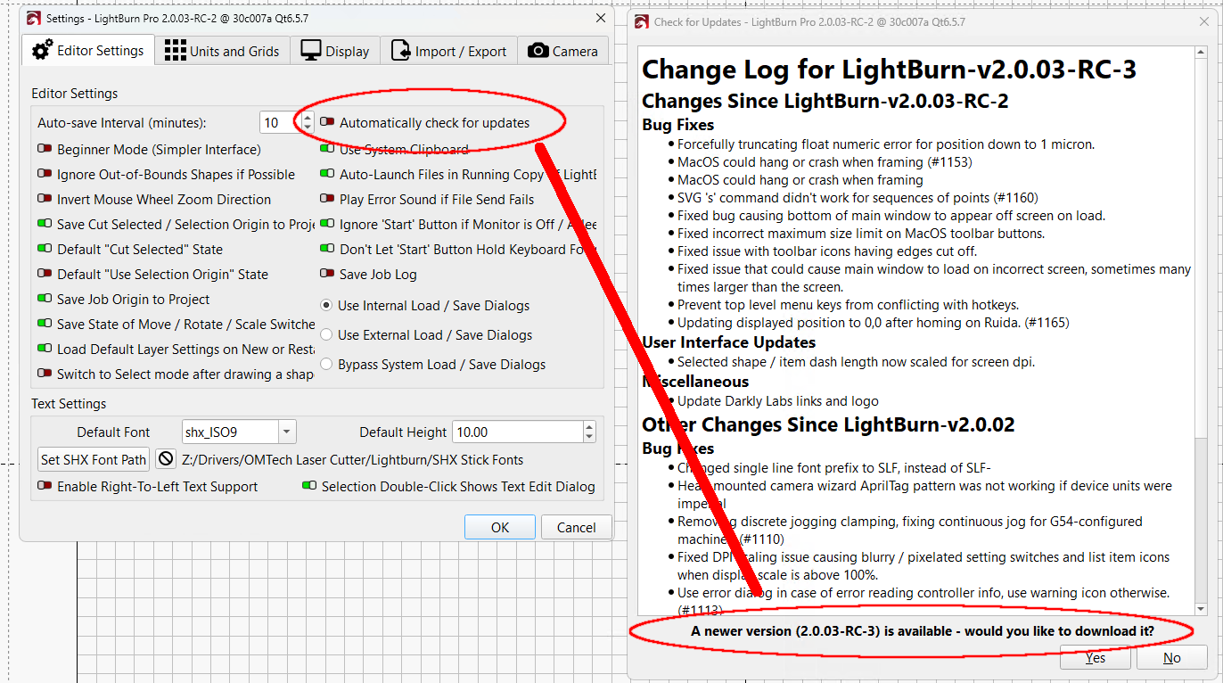

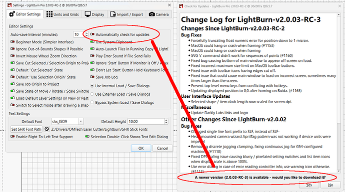

Apparently Release Candidate versions ignore the Automatically check for updates switch:
That’s in RC-2, but it’s probably true for all RCs.
At this point I’m holding in RC-2 due to the window glitches in RC-3, so I must refuse “would you like to download it?” every time. :frowning:

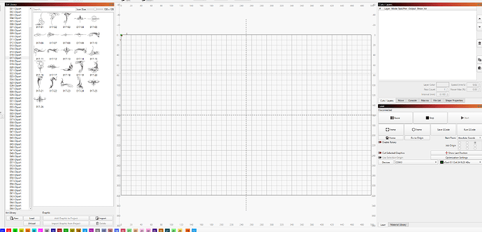

@Rick I do not know if this has been discussed. After I setup a screen and set the control panels as I like. If I minimize the screen and then maximize, or move the screen over to my other monitor, or exit lightburn, the screen resets. I have attached screen shots of setup and then after moving the screen onto my other monitor. This is in my office with my test system, and not attached to laser
Yes, a lot of internal discussions and a new RC dropped this morning addressing the windowing and restoration of layout. :slight_smile:
