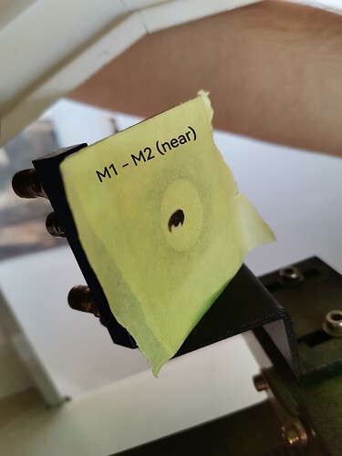

Here you are,
It is obvious thar mirror 2 to mirror 3 relation is not aligned, it was and I have no idea how that messed up. Also I did not managed to figure out why my red-dot looks like a bar. The beam also looks like a bar at mirror 1 to mirror 2 (far).
It was and I don’t know
The mark at Mirror 2 is very distorted, rather than round.
The tape is at a 45° angle to the entering beam, so the spot will be wider by a factor of 1.4, but something is badly wrong with the overall shape:
The beam is more than 3Ă— wider at the far point and the distortion has turned into a tail:
The spot at Mirror 1 looks reasonably good, so perhaps Mirror 1 is damaged. If the mirror is good, then the beam shape at Mirror 2 confirms @jkwilborn’s suspicion the tube is not operating in TEM00 mode.
As I explained, a bar is the shape of a defocused diode laser beam. The red-dot module is focused to produce a small dot at the platform (about 1.5 m away through the main beam focus lens), but will be defocused at shorter distances (just outside the module at the main tube).
I initially thought the red-dot module in your machine is incorrectly focused at the platform, but damage to Mirror 1 could account for its shape.
Take a close look at Mirror 1 and upload a picture with the mirror reflecting a plain background so we can all see what you see.

I took 2 pulses just in front of the mirror 1, one on the plywood and the second one on the paper tape.
This is preparation.
Here are the results.
I wanted to see the surface of the mirror, because I assumed the laser beam is properly shaped and the mirror was damaged, but this picture contradicts that:
That “hole” in the beam pattern shows the tube is not resonating in TEM00 mode, which explains all the effects you’re seeing.
Unfortunately, the only cure is a new laser tube.
How? When the laser beam is in good condition at the entrance of the mirror 1, it does not make sense for me.
The beam is not in good condition.
Although the spot is round, the unburned area in the lower left quadrant shows that the energy distribution isn’t correct over the entire beam. It should be more intense at the center and taper off symmetrically around the perimeter, which it does not.
The two pictures at Mirror 2 show the same shape, somewhat enlarged due to the beam spreading.
@jkwilborn’s post at his link shows the correct beam shape. Note the similarity of the beam shape from his “bad” tube to your pictures:
So the tube in your laser is not operating in TEM00 mode.
