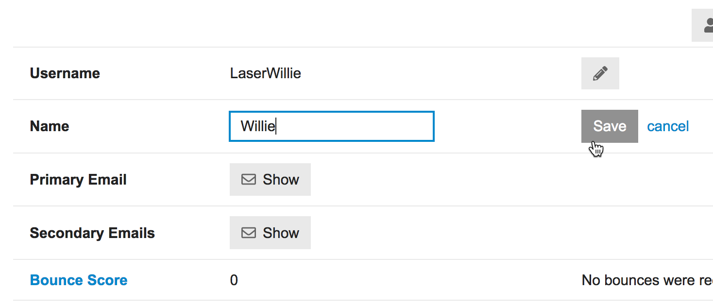

But first I would highly recommend changing your names addition. It is always unfortunate to have an e-mail address in a public place, many robots catch it and you get nice ads with breast implants or investment proposals from Uganda … :wink:

NOTE: I edited your forum profile and changed where you entered “NAME:” as the email address.
If you want to edit this or change things in the profile, you can edit this by clicking on your profile icon in the top right (on desktop browser), clicking the gear icon in the menu that pops up, and going to the Profile tab.
