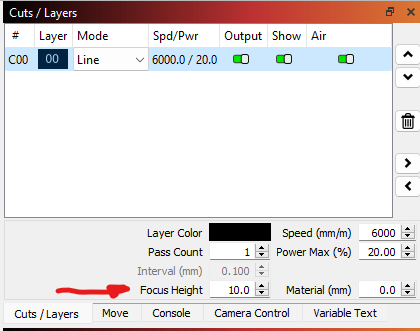

Can you share a screenshot of your device settings? I see a few small discrepancies in the gcode. Particularly with your power settings. The start of your code says this;
; Cut @ 6000 mm/min, 20% power
However, the gcode is setting S200 which would be proper for GRBL’s default S-value of 1000. Snapmaker needs an S-value of 255.
M03 P20 S200
Also, there is a Z movement right before it begins the first cut;
G0 Z10
; Layer C00
This usually will only be here if you have enabled Z axis on (and set a material height). Either disable Z-axis, or enable relative Z moves only.
EDIT: I am unable to replicate it in Lightburn doing it without inputting a material height manually. If I leave material height at 0, it doesn’t put the line in.

Make sure focus and material are both 0 if you’re doing the origin and focus yourself.

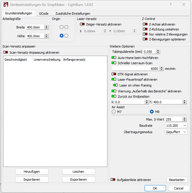

Screenshot 2023-08-14 124130
The Max-s Value I took from the “outdated” manual “How to connect Snapmaker”.
Good to know that this is wrong and should be 255.
Z-Axis should be ddisabled? And “Unterstützung” also zero?
Thankfull for every hint …
Is this now correct?
Yes, that seems to be correct.

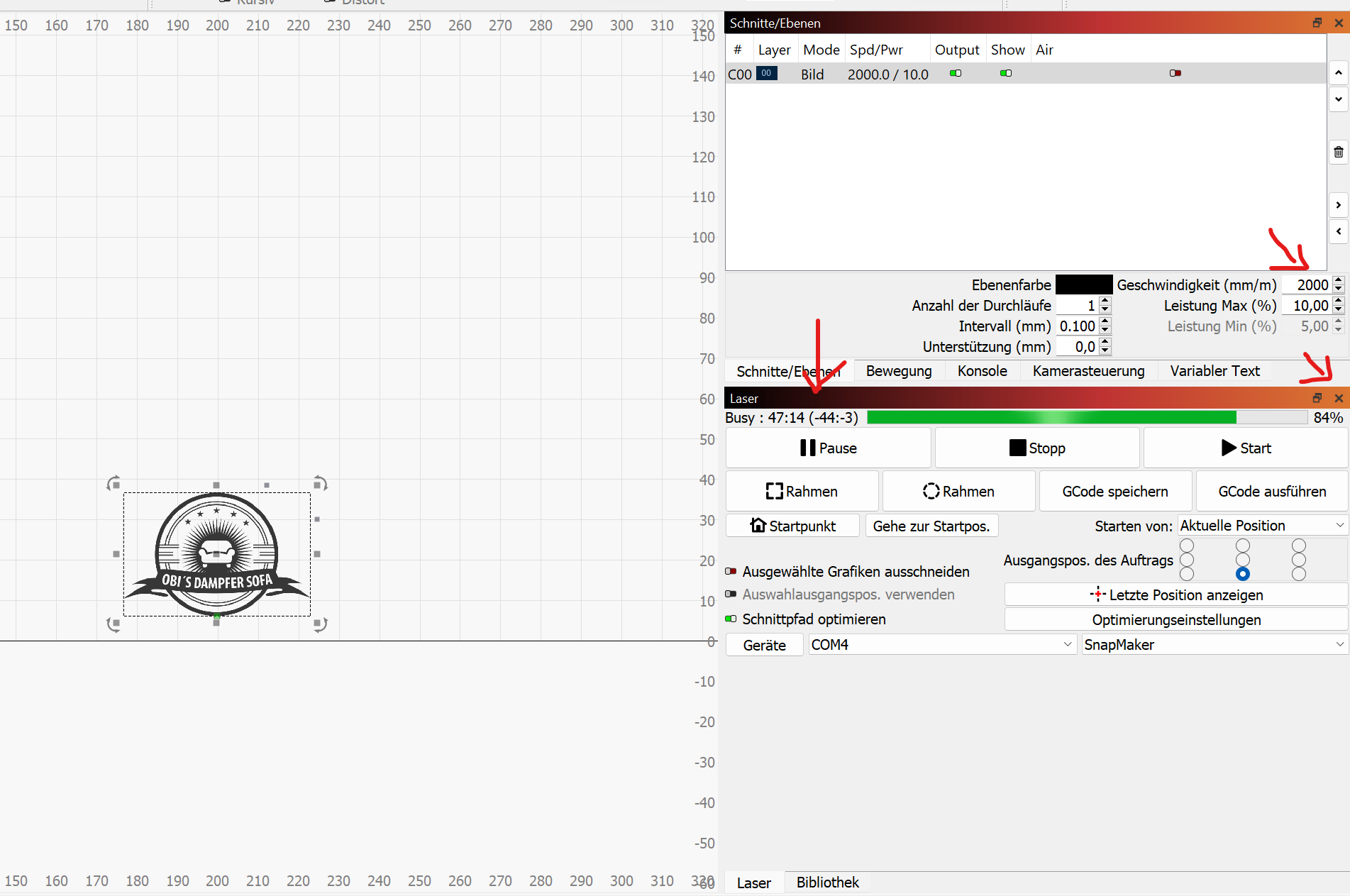

@Skreelink I try currently the setting what you recommended. It works fine so far. Also the 10mm Z lift up is gone with “Unterstützung” = 0 … BUT … it seems that the speed settings are slower then expected. If I try this logo in image mode it needs more then 1 hour (with 1500mm/m or 2000 mm/m) If I do a comparrable job with Luban it needs lot less time. I would guess that the speed settings are not really the reality. Do you have any idea whoud it could be and what I should chnge? I will attache again the gcode. Thankfull for any hint. (seetings are now as in last post picture)

Luban is notoriously for bad estimates, however, also keep in mind that since it’s working in degrees it is moving less than a mm per degree. When you set 1500mm/min, on the rotary, by gcode you’re actually setting 1500deg/min (since that’s the unit the rotary moves in) and that will influence surface speed depending on the object’s circumference. 1 degree = 1mm only in an object with a circumference of 360mm or diameter of ~114.5mm.
The listed spec for the rotary is 45 deg/sec. You can do some advanced math to convert to match your material yadda yadda. However.
Instead, you can make Y do the bulk of the movement (and actually do the moves in mm/m) by setting the scan angle to 90 degrees, so the bed will move back and forth instead of the rotary.

I did a little math and created a formula. This could be included in LightBurn. If I want to get a certain speed, but the given value is simply “abused” by the software, then I have to calculate a suitable factor depending on the diameter of the object. This is easier than I thought at the beginning. Example: I want to laser at 1500mm/min, but Lightburn makes it 1500°/min, then I have to calculate how many °/min I need to get to 1500mm/min in the end. I calculate for that:
360/(d x Pi)=factor (D= diameter, Pi= 3.14…)
Now I take my 1500 and multiply it by the factor. I then set the result in Lightburn as the speed in order to obtain the desired speed at the end. You are welcome to try it out. It worked for me in all the counter-calculations. This would mean that if I set 1500mm/min as the desired speed in Lightburn, LighBurn could simply calculate the factor, multiply it by the speed and automatically set it as °/min for the rotary module. This is not rocket science either. LB knows the diameter, which I enter in the Rotary Setup. Now it would be good to know the maximum value of the rotary module and enter it in LightBurn if necessary. For the Snapmaker Rotary, this would be 45°/second. This makes it easy to calculate what the maximum possible speed would be for a certain diameter. Here is the simplified and shortened formula for the maximum speed: Diameter multiplied by Pi multiplied by 7.5 → d x Pi x 7.5 = max (real) Speed. But that would also mean that it cannot achieve the desired 1500mm/min with a diameter of 43mm. Good to know :wink: and would also explain why I could not see any difference in my test matrixes at different speeds, as the maximum value had long since been reached. Can anyone find an error in my calculations?

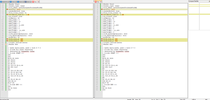

50mm object;
; G-code START <<<
G90
G21
M106 P0 S255
G0 F3000
G1 F3000
G0 X0.00
G0 Y10.00 B-11.46
M3 P50 S127
M3
G1 Y10.00 B11.46
G1 Y0.00 B11.46
G1 Y0.00 B-11.46
G1 Y10.00 B-11.46
M5
G0 Y5.00 B0.00
G92 B0.00
M107 P0
Movement goes as follows;
G1 Y0.00 B11.46
G1 Y0.00 B-11.46
From positive 11.46 to -11.46 == 22.92 (rounded up from 22.918 we got before.
Same exact thing, 2:1 with 100mm object.
; G-code START <<<
G90
G21
M106 P0 S255
G0 F3000
G1 F3000
G0 X0.00
G0 Y10.00 B-5.73
M3 P50 S127
M3
G1 Y10.00 B5.73
G1 Y0.00 B5.73
G1 Y0.00 B-5.73
G1 Y10.00 B-5.73
M5
G0 Y5.00 B0.00
G92 B0.00
M107 P0
-5.73 to 5.73 = 11.46 units of movement. So Luban is also working in degrees, and the speed still lists as F3000 (in these examples). So X units at 3000 units per minute, or deg/min.

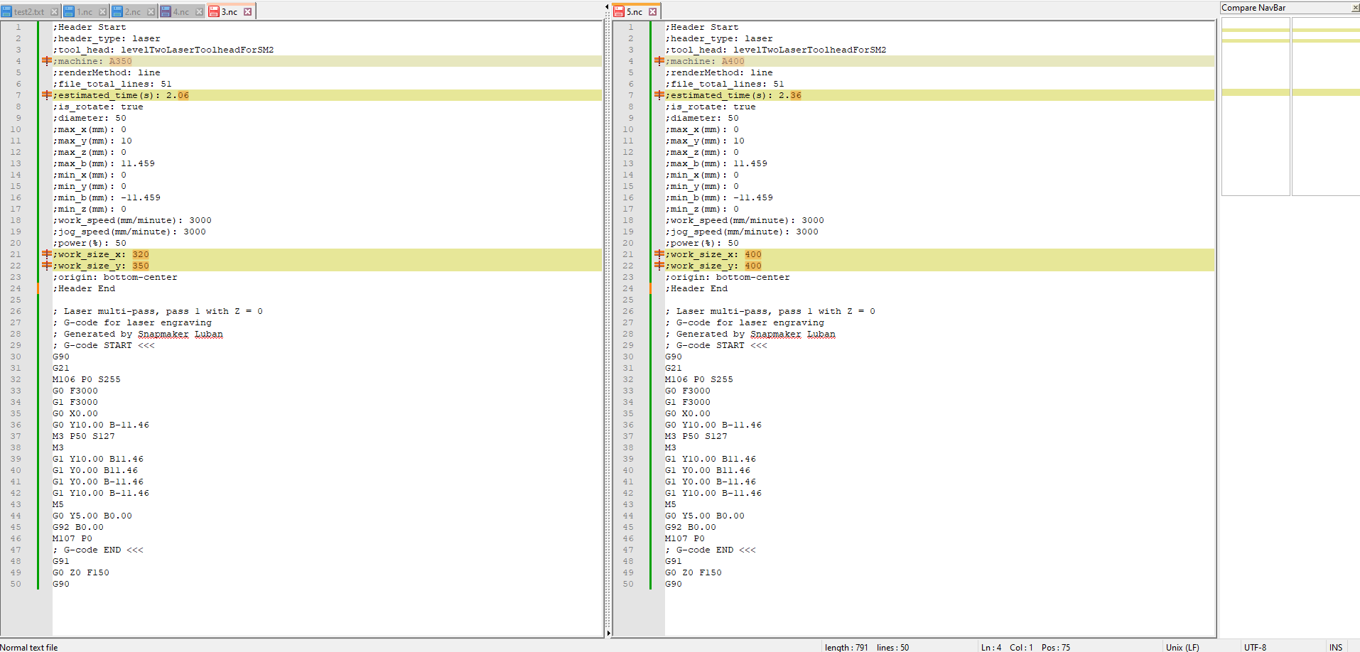

While written a bit differently, the end result of the gcode is exactly the same, along with how it turns the laser off.
EDIT2: I swapped the machine in Luban between the 2.0 and the Artisan, and it spat out the EXACT same gcode file. So that’s good to know.
2.0 on left, Artisan on the right, thumbnail hash truncated for readability.

Can you export the gcode for a 50mm square on both luban and lightburn and send those to me here? Sorry to say I agree it’s likely firmware. We emit the M5… at that point it’s out of LightBurn’s hands. But I want to see what’s different between Luban and LightBurn.
