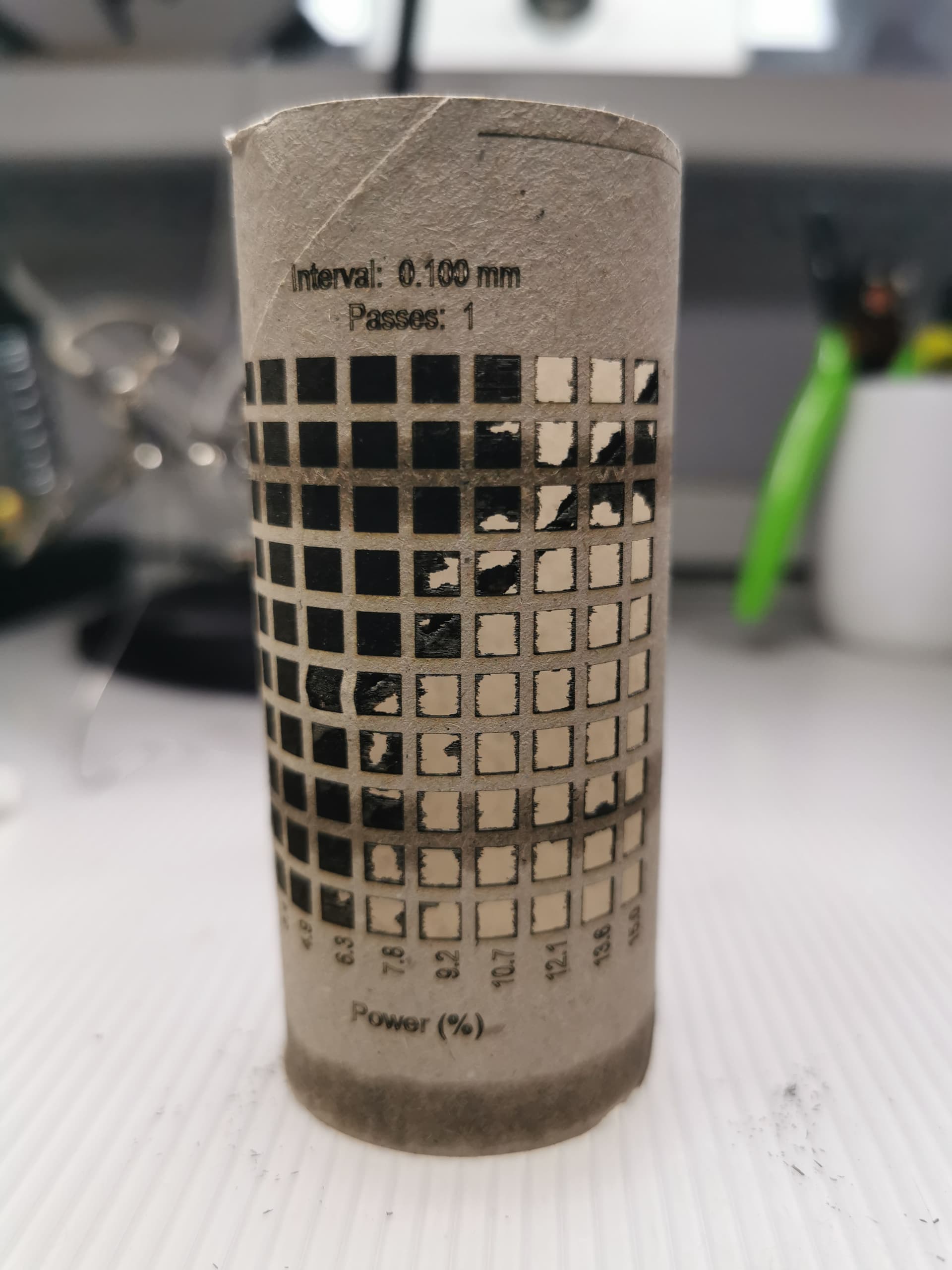

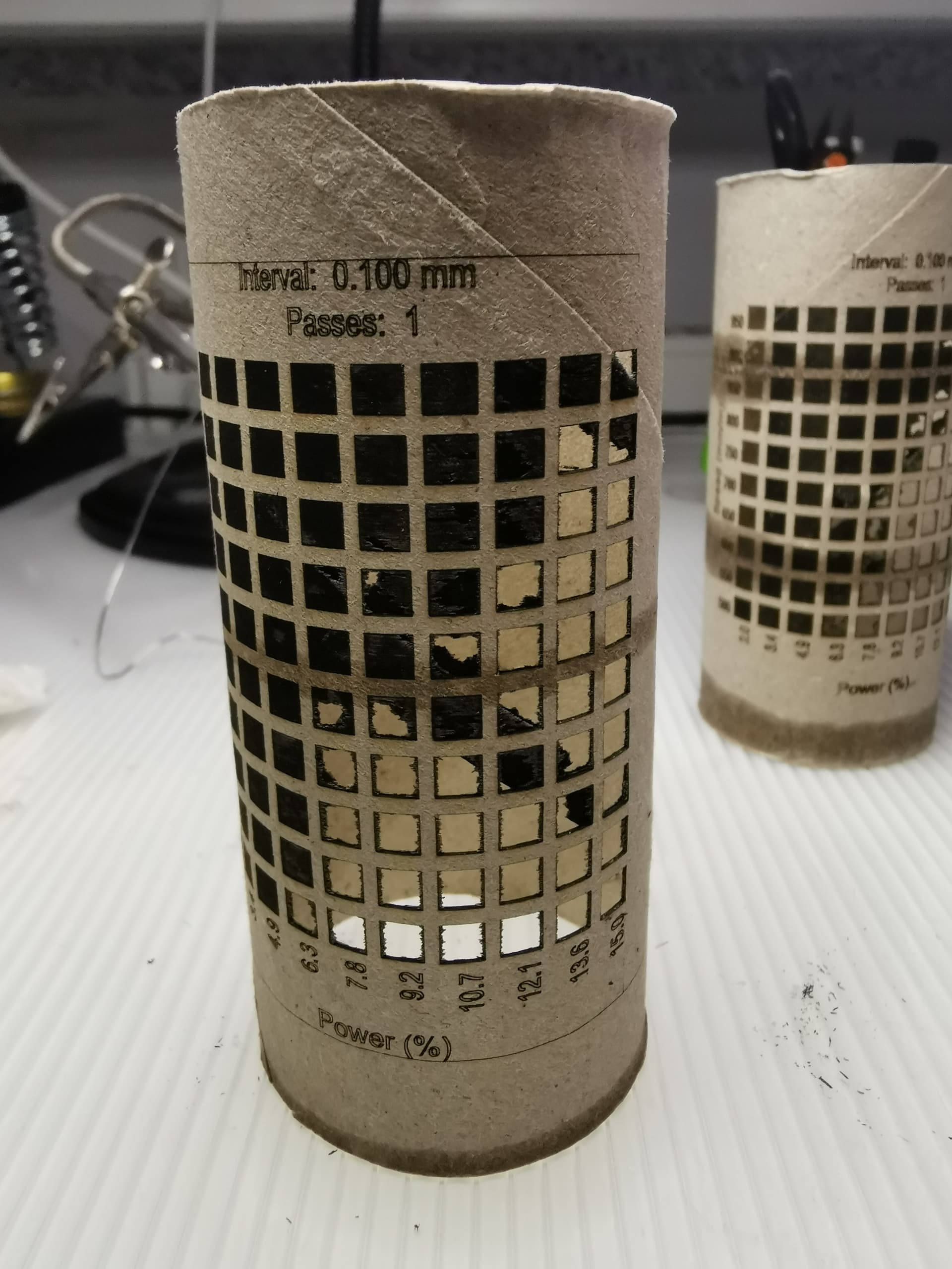

@adammhaile your latest update is a little bit slower then the one before.
First try: 1h:33min , second try 1h:36min
See the outcome in the pictures below:
First test:
Second test (latest update from today):
You can also see that on both speed and power is chaning … not all the same speed
Power: 2%-15%
Speed: 500-950 mm/min (littel bit less then the max speed for 43mm diameter)
