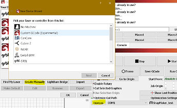

Check if a Custom GCode with Snapmaker Flavor device will work for you.

Did you test with Custom GCode to see if the thumbnail lines are produced?
Just an idea.
