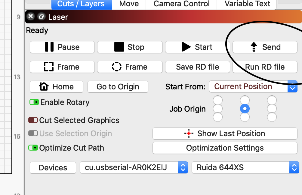

I create my design - in this case it is just a name
I send my design to the laser
it says that it goes like normal (no errors)
however when I go to my Mira 7, and pull up the “Files” where they always show up there is nothing there.
I can even send the same file name without getting an error
I have my design in the grid space. I click send to laser. I hit the frame button on my laser, and it continues to frame the last design I sent to the laser before upgrading to the new version of lightburn. When I hit start, it starts to cut the design I sent to the laser before upgrading lightburn.

This is very strange. Stephanie - Your log file looks fine. It appears the laser is communicating as expected, responding the way it should, and everything ends correctly in the file.
Angelica - Yours looks like the machine has just stopped talking to you after the file is sent. If you look at the controller screen, is the timer running or anything?
Do either of you have lots of files hosted on the laser itself that could be an issue?
I had 4 files in my laser which I deleted and it’s still doing the same thing.
I honestly can’t say why it’s doing this. My own Macs are working correctly, and files send and run as expected.
As I mentioned before, we’ve always had issues with MacOS and USB connections to Ruida controllers - not all users experience this, and not all versions, but I’ve never been able to figure out what the cause is. The chip used by Ruida controllers (FTDI) has a driver that conflicts with the one supplied by Apple, and that can cause weird issues. If you’re using a USB hub or USB-C to A converter, sometimes those are the problem, and just unplugging and trying a different USB port can help.
Ultimately, the most reliable option is to buy the USB to Ethernet adapter from Apple ($30) and connect a network cable directly from the Mac to the laser.
