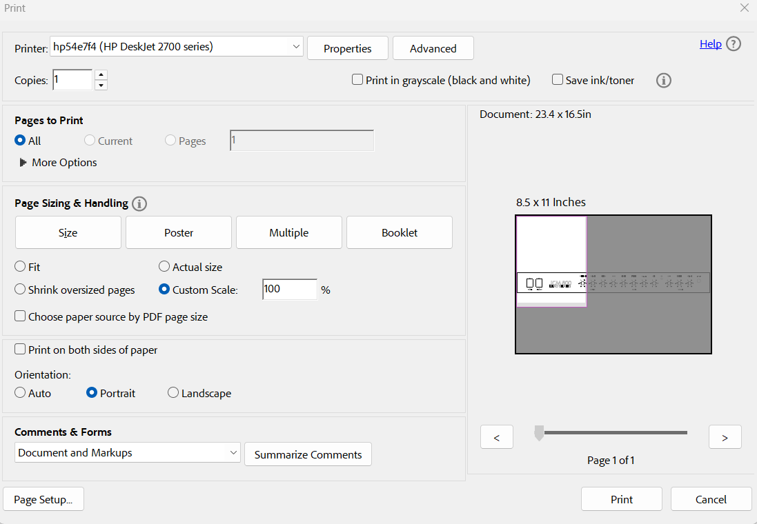

The issue, which I’m sure experts will already know, is that there doesn’t seem to be a way of making LightBurn print out a design to paper or pdf without it applying some sort of scaling. In my case my design is 67x660mm so I have adjusted the canvas size to match (btw. I am using the no machine option). When I print to a windows printer OR PDF the design is shrunk down to fit the paper so it is completely useless. I would like it to print it actual size and spread it over a number of pages so I can jigsaw them together and end up with a real size print out for further analysis.

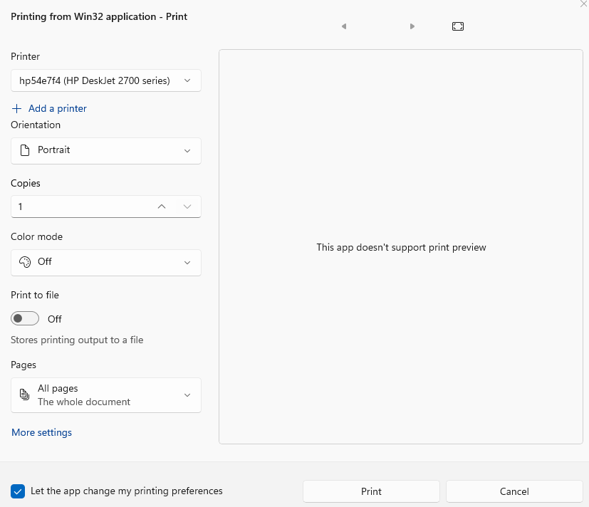

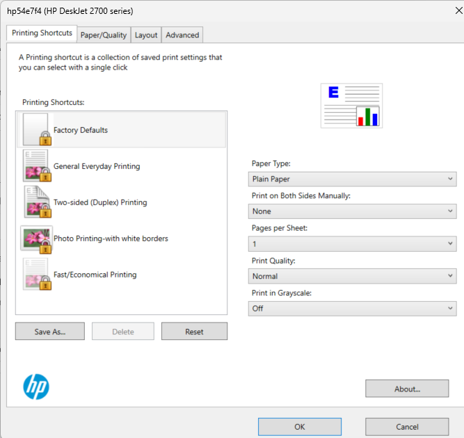

I am attaching my printer screenshots, I see no reference to scaling. The odd thing is that inkscape does print without scaling as I stated previously albeit cutting the image off due to the paper not being big enough.
GaryG…
I can find no other references to scaling in any of the other options.

I don’t have a D size option so I tried A2, then I get different options:

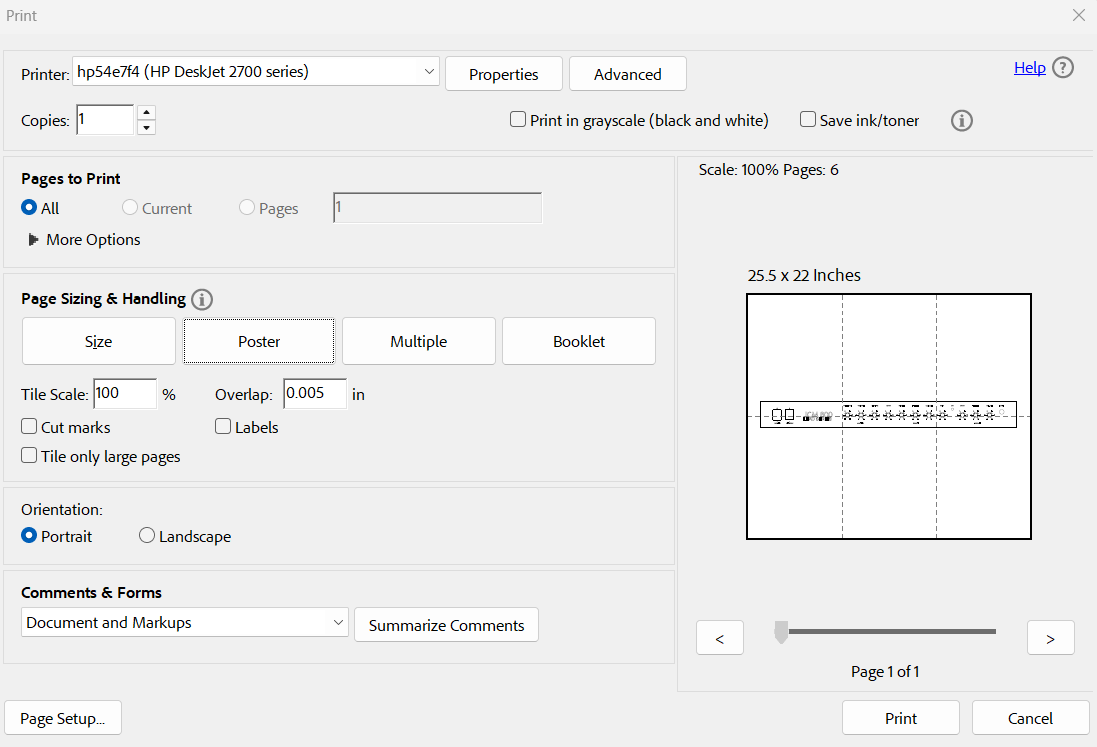

The ā€˜Poster’ is what I’ve been looking for:
So the PDF is created with the image without scaling over multiple pages. There is a small gap at the edge of pages as another commentator mentioned but I can live with that.

By adjusting ā€˜overlap’ and using ā€˜cut marks’ feature there is no information lost at the edge of the pages you can trim the pages and join perfectly.

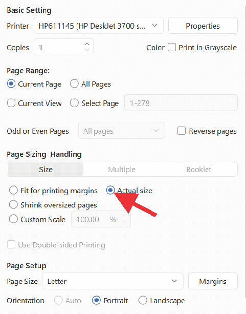

Someone asked for some links to others struggling with printing to paper and scaling issues. Here are a few. My recommendation is to add something to the online documentation advising people about how to print drafts to paper/pdf and avoid scaling. Hope this helps.
There is some guidance here about printing to scale: Print - LightBurn User Guide
Specifically:
Saving the workspace as a .svg or .pdf and printing externally to LightBurn may be the best option here.
