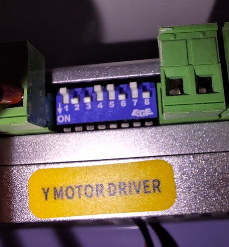

Can you show me a photo of the motor driver switches and what type of driver it is?

One note, the “read settings…” is not getting the information from the RUIDA. I put in a value of 100 for the steps/rev and then hit the Read Settings… and there was no change. The dip switches on the Y drive indicate the 6400 steps/rev. “Test” runs the chuck about 4.5 full revolutions and then back to 0. I downloaded RDWorks V8 yesterday and set it up to perform rotary operations and it gives me the same results. I would like to eliminate LB as the issue so that I can get closer to the resolution.
What model of motor driver?
It’s easy to misread the switch settings. ON is usually towards the circuit board and ON direction is also marked on the switch.
There isn’t much to how the hardware interfaces, but it has to be as specified if the motor diver is going to move the motor the correct amount.

On my machine, the switches are set to 2000 steps/rotation … on the fiber they are 12,800 steps/rotation.
These images are the Y-axis drive control, DIP switch settings, and the RUIDA control module of my machine.

These look good, I think you read them correctly.
Using these settings, is it doing the 4.5 turns when you press test?
Basic hardware is pretty well eliminated if your normal Y axes work properly.
Yes. These settings gives me the 4.5 revolutions.
