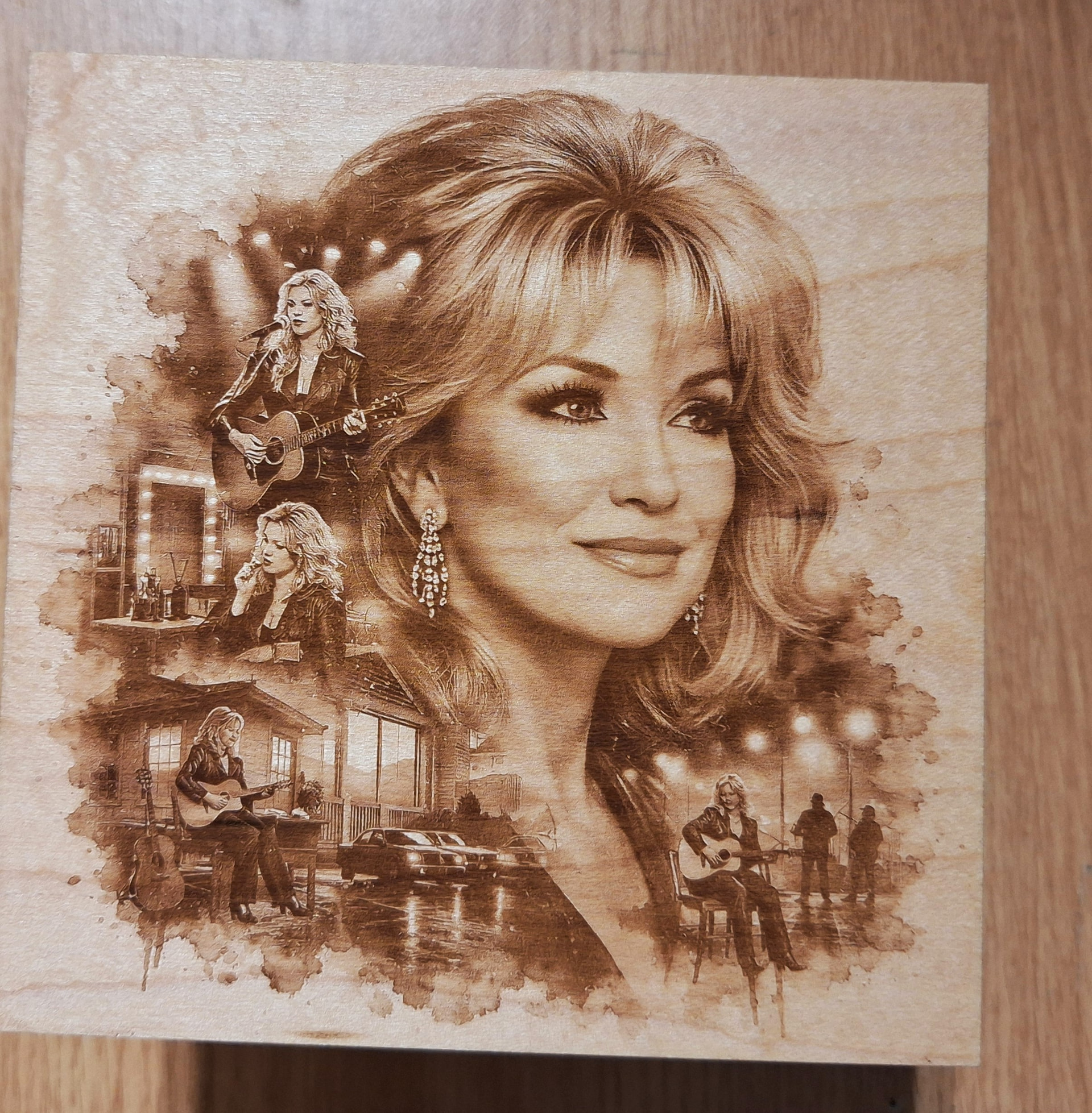

You can check out some of Nicky Norton for an idea of what is possible. He has a number of lasers. Of course it depends on the material.
These are done on a 60W MOPA fiber laser using aluminum or stainless coated cards.
And on leather with a 5W diode.
Compares Stucki and Jarvis.
These are only to show you that you can do some incredible reproductions using a dither.
