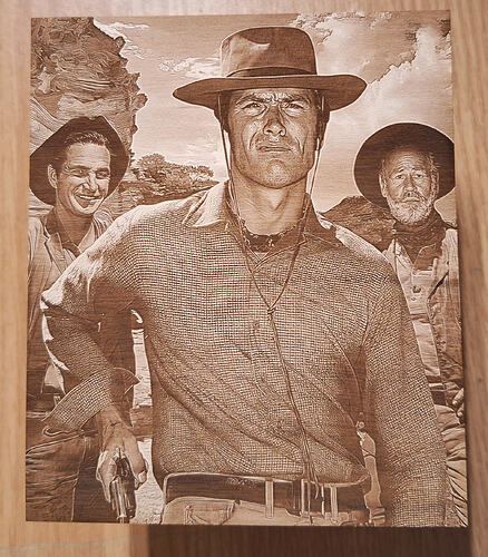

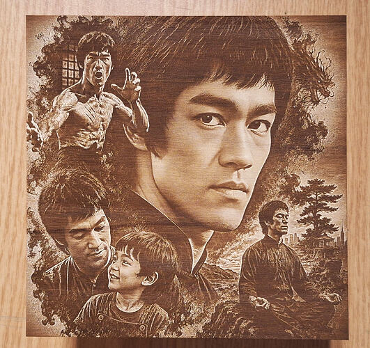

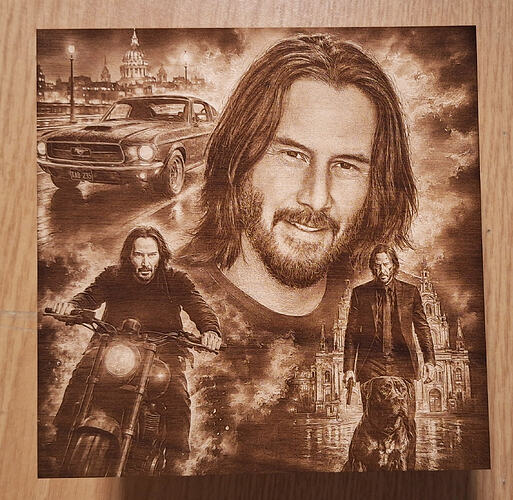

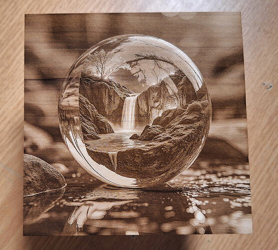

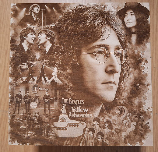

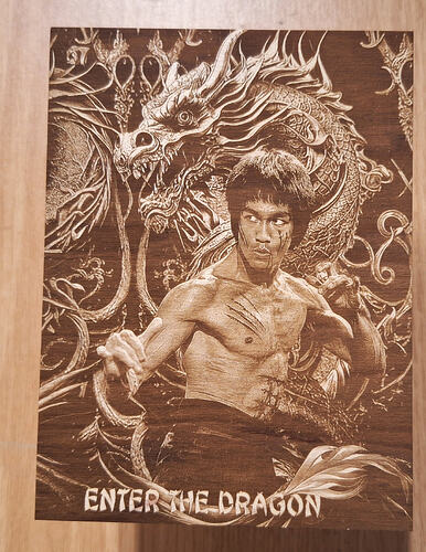

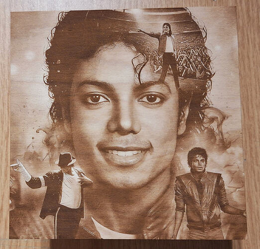

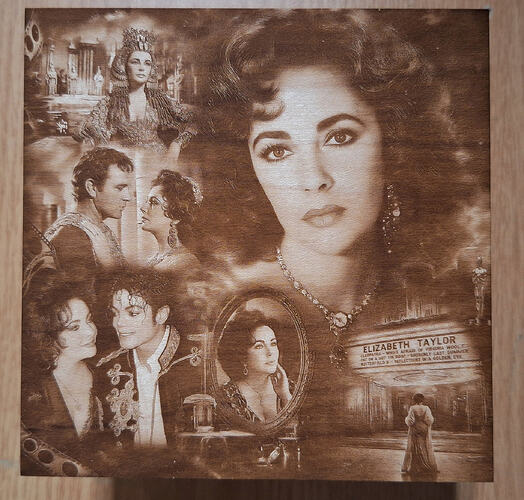

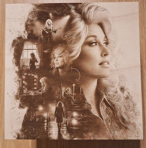

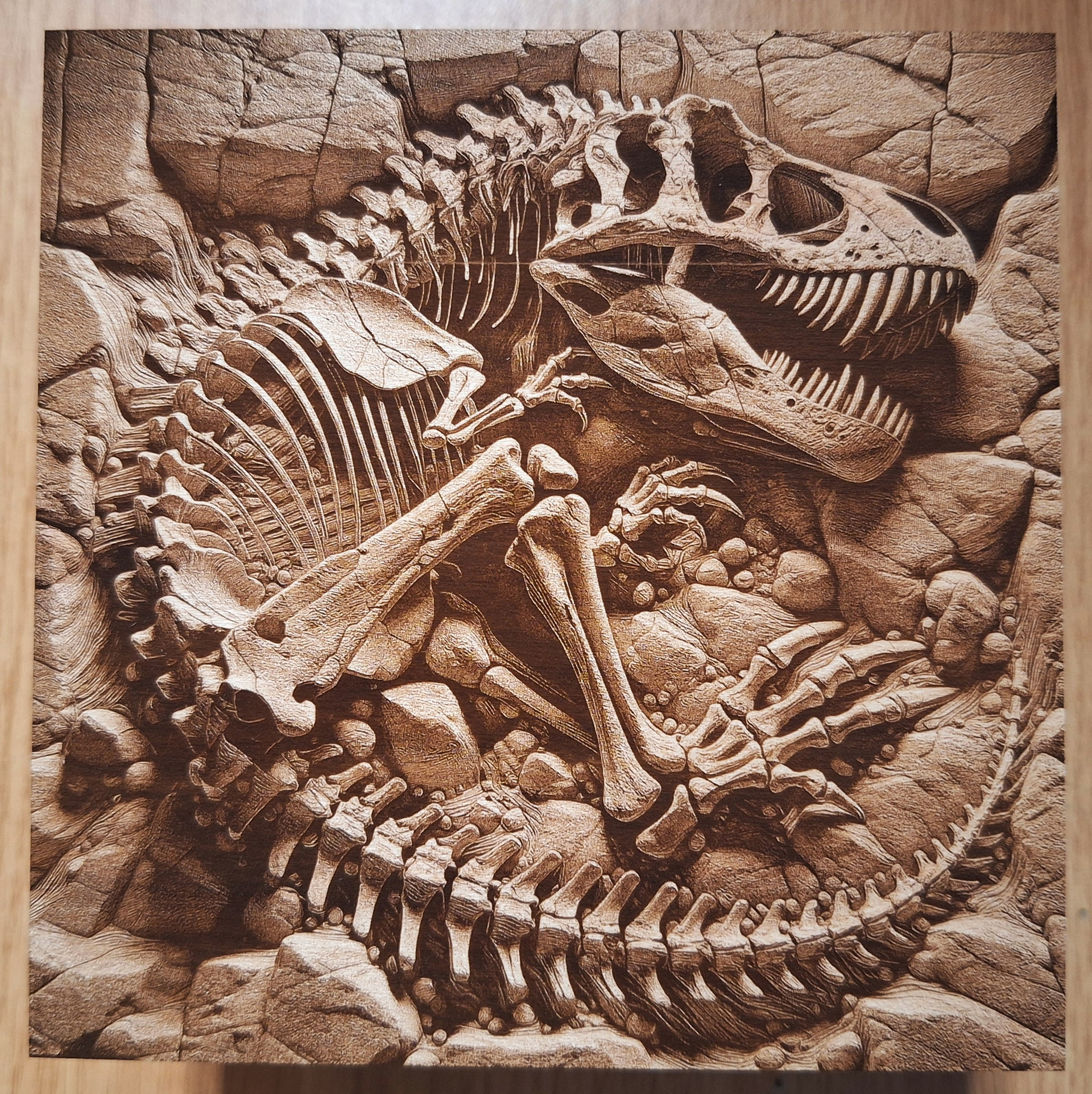

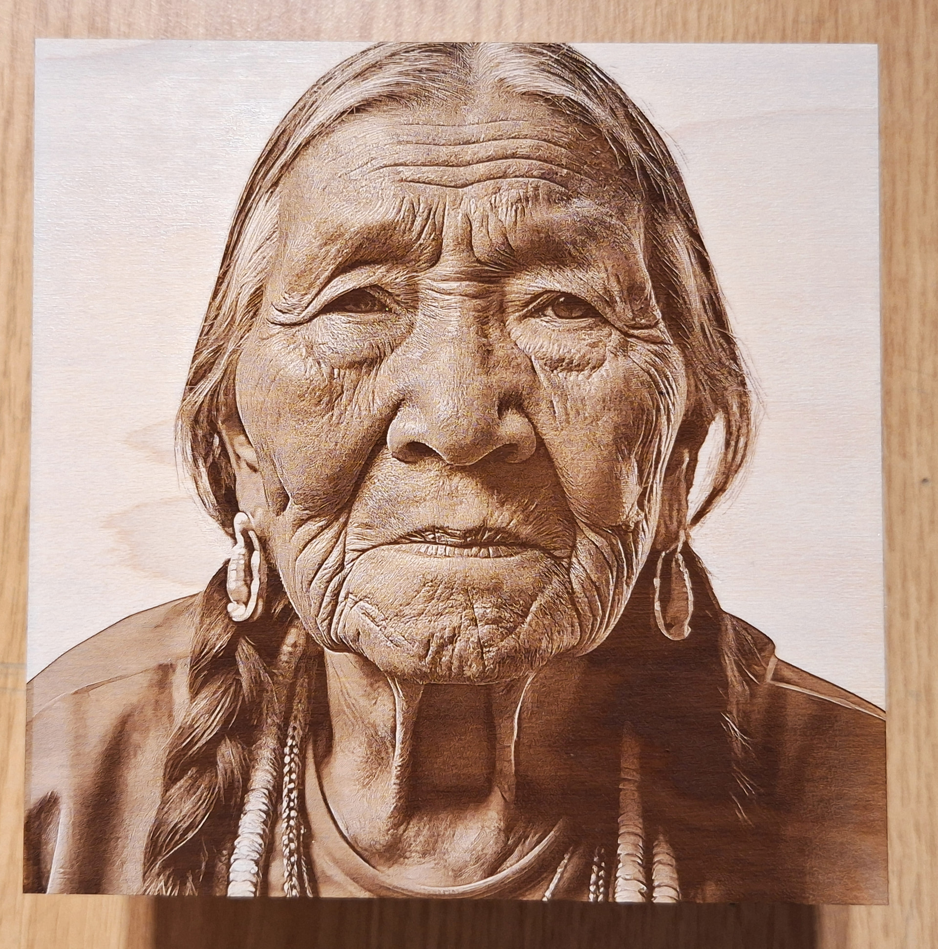

Playing with AI images and engraving with 5 watt UV
Playing with AI images and engraving on Maple plywood

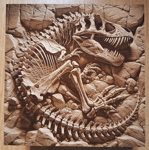

F330 lens
85/45kHz/3 ns
LightBurn Stucki 380 DPI

That AI makes quick work of what would normally take forever. Just have to watch for little things like extra fingers, a foot on the end of a tail instead of the leg, little things like that.

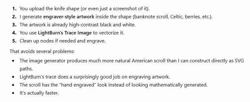

I’ve been using the $20/month subscription of ChatGPT, I tried several and it works best for my needs. I would run out of data with the free version, and also the paid subscription gives a lot more detail. For scroll work, celtic knots, text fitting inside a shapes, other fills it does in 30-40 seconds what would take me hours or days. And the images produced trace perfectly in LB without any cleanup for the most part. I tried having the A.I. output SVG files directly but didn’t work so well.

So these are AI generated mock-ups of how it might look on wood? Do you have any examples where you have tried a real world test with this source material?
I’m pretty sure those are the real engravings.
I really don’t think they are unfortunately. I can’t see how white highlights can be created on the wood and there is a very strange fake grain effect consistent in the renders.
@tomgeen
ALL these images are engraved on wood as in description

When I engrave cutting boards for a customer, I will get white where the pattern is normally black. I notice it often happens when engraving over a grain (hard part) of the wood. And it happens a lot in bamboo.

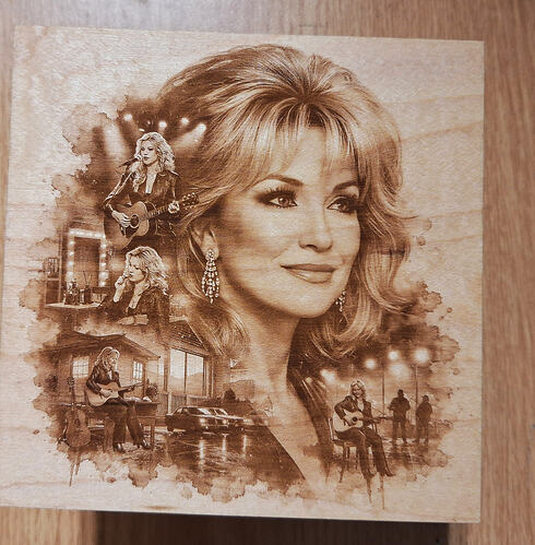

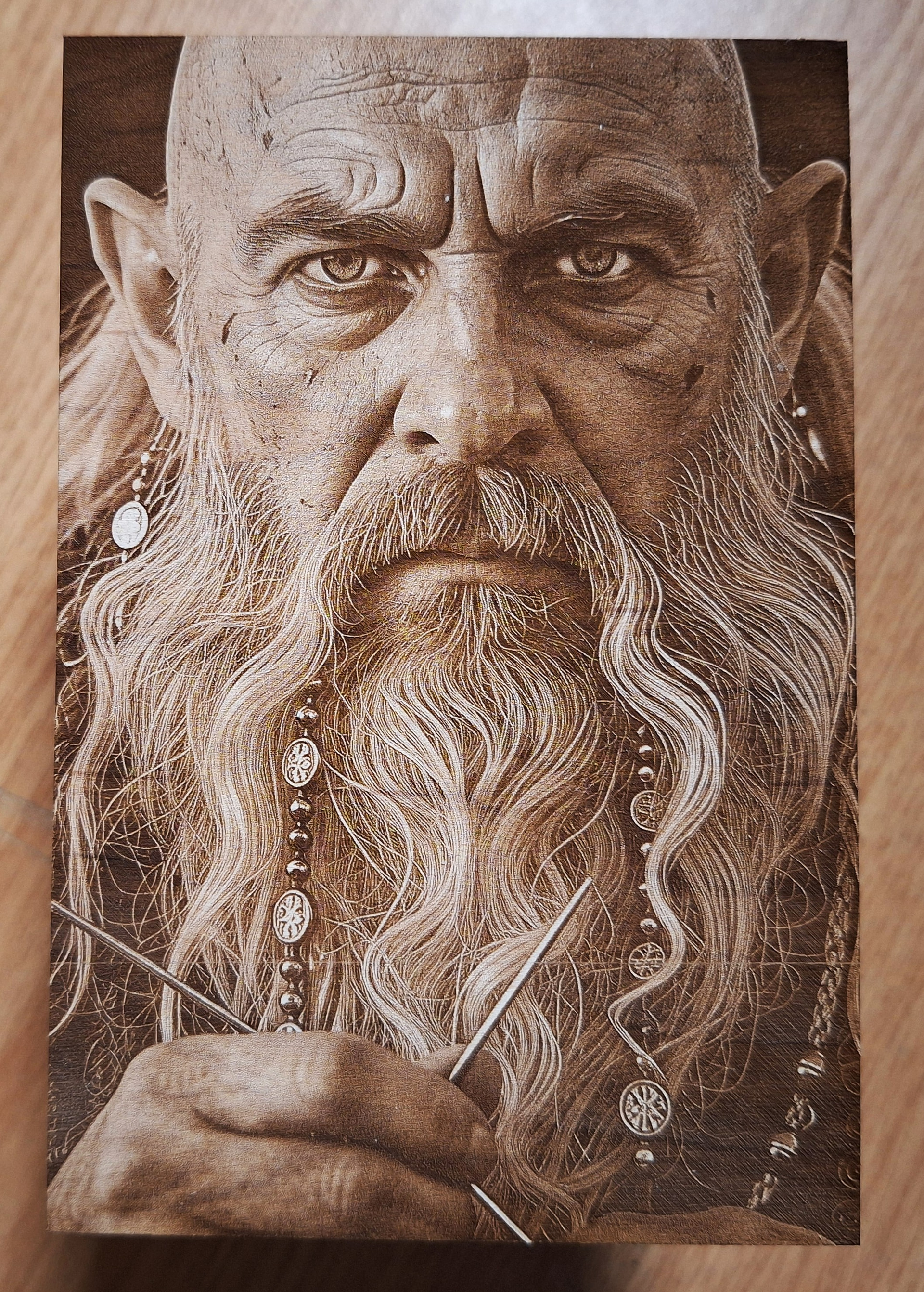

@jkwilborn I guess These engravings
would blow him away
Maple plywood
5 watt UV
85/45kHz/3 ns
LB stucki 380 DPI
Excellent, work as usual.
Thank you for providing the job settings.
