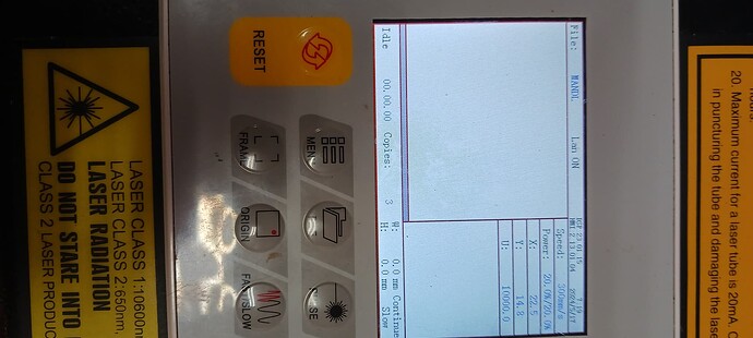

I may have missed this but not seeing this.
Can you take a photo of the panel showing your IP configuration?
Also, can you confirm the IP address and netmask of your LightBurn computer?

Okay, I am uploading photos requested, I miss read my ping info NO PACKETS LOST. but laser is still disconnected direct computer to laser.
my ip : IP4v 192.168.1.202

No worries. I can make it out.
You didn’t list your netmask but based on your IP I will assume that it’s 255.255.255.0.
Is 192.168.1.202 the IP of your wifi device or is that ethernet? Note that if you are connected directly from computer to ruida that you will not be able to share the same subnet between your wireless and ethernet.
I’m actually surprised it’s working at all so I’m questioning if there’s another device on the network that’s actually assigned 192.168.1.100.
Try this:
  1. Set IP of Ruida to 10.0.3.3
  2. Manually configure IP of ethernet on computer to 10.0.3.100, subnet mask 255.255.255.0, gateway of 10.0.3.3
Once configured, ping 10.0.3.3. What are the results?
If you get a positive result then change IP address of LightBurn device and retest.
